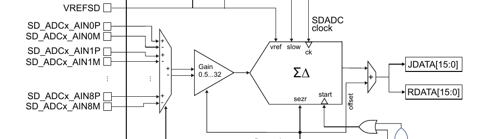

STM32F373CCT6 2 Channels Single ended wired together for 16 bit ADC interleaved 50 KHz to 100 KHz , Can it be done with 2 Differential channels at same speed 50KHz to 100KHz or is it stuck at 16Khz max speed in differential mode
Device STM32F373CCT648 pin
We currently using 2 single ended 16 bit SADC inputs one on SADC1 PE9 and one on SADC2 PB2.
We interleave the two 50KHz single channels using a 10uS delay between them. This uses DMA SADC transfer an interleaves the signal to achieve a 100 KHz sampling rate needed for our niche application.
The two inputs pins PE9 and PB2 are tied together to the output of our signal op amp the opamp has one output wired to both the PE9 and PB2 pins.
The single opamp has two wave forms in the same signal they are separated by an index pulse to separate the sampling into 2 bins one for the ref and one for the sample part of the waveform.
The system works great, the 100 KHz oversampling increases the resolution of the system by oversampling.
Were are making an new version of the design with a different detector sadly the SNR is lower.
We want to use two channels again of the SADC1 and SADC 2 but this time using differential mode as this increases performance common mode rejection.
This means we need 4 pins of the micro as differential requires 4 pins.
We choose PB0 & PB1 SADC1 and PE8 & PE9 SADC2
We want to wire the plus inputs together so PB0 and PE8 differential plus inputs go to the op-amps output
We will wire the - inputs to the Analogue Gnd 0V to pins PB1 and PE9
in single ended mode we run in fast mode 6Mhz SADC clock to get 50 Khz interleaved to get 100 KHz sampling rate
IN differential mode I here the Max Sampling rate is 16.3Khz is this true? Or can it run at the full 50 KHz in Differential Mode.
1) Will the differential mode only support 16.3Khz max sample rate??
Does this mean interleaved we can only get 16.3 KHz * 2 = 32.6 KHz max sampling rate
Or can they run at 50 KHz * 2 = 100 KHz they work fine in singled ended mode at this max sampling rate when interleaved.

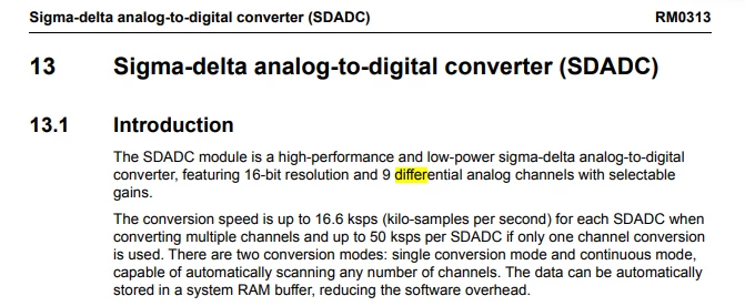

Have a look at reference manual RM0313 page 230 onwards.

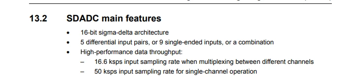

What is unclear is whether, when used in differential mode this counts as multiple channels 16.6KHz or counts as single channel (50 KHz)
Does the SADC measure the top and bottom pin of the differential input pair = 2 pins and takes 2 measurements does this decrease the speed from 50Khz to 16.6Khz or does it just measure the voltage across the two pins and counts as a single channel?

Here is a snippet from page 231
Is it 50Khz or 16.6Khz for a differential channel

you can get 50ks from one ADC - single or diff. input .
so using 2 ADCs in interleaved mode can make 100ks , also on diff. inputs.
just look, whether there is some "extra" limit on some channels (some have "slow" or "fast" name) and choose the best on each ADC (if there are slow--fast on this chip).

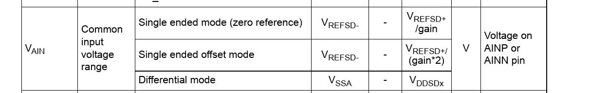

you can put inputs together as in single ended in, just respect the common mode input range (see in ds )
_legacyfs_online_stmicro_images_0693W00000bkvMJQAY.png+

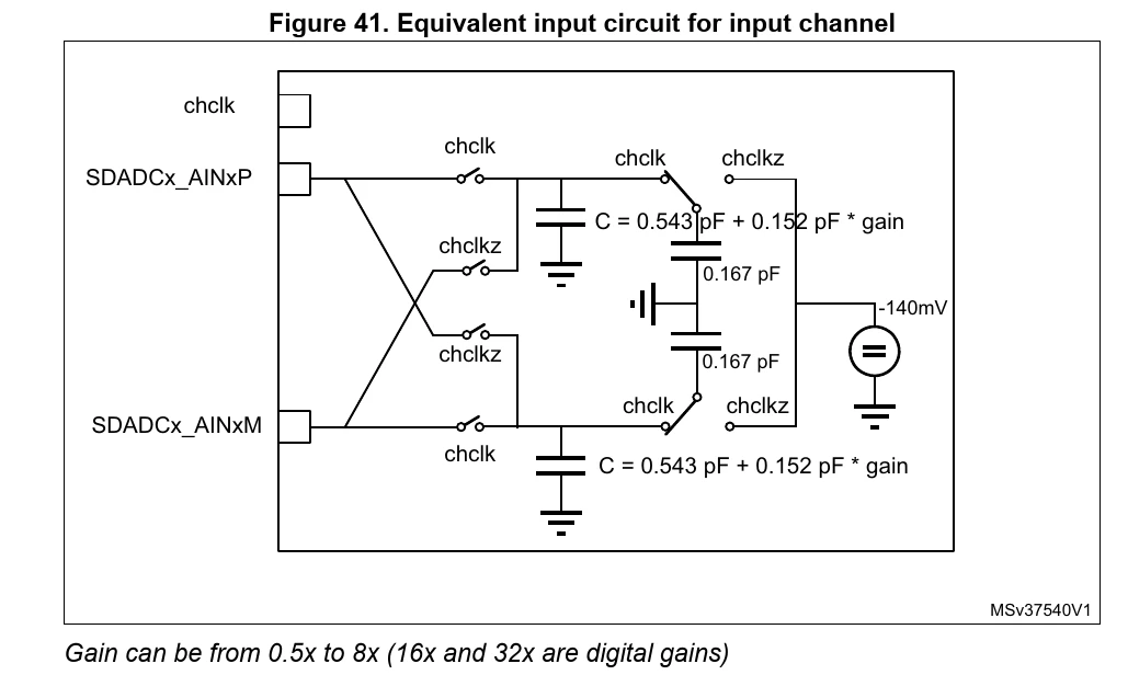

as you can see (15.3 sdadc...) each ADC has its diff/input mux in front:

We will ensure the signal respects and is within the common mode input range we will scale our amplifiers output to ensure it is within the common mode input range for the differential pair

good...and i see on quick look at rm no fast/slow channels, only (fast) SAR ADC seem to have such.
see input mux for a channel, always +/- inputs there, can only choose to use them or leave one input at gnd -> single ended then.
so anyway inputs have diff. input stage:

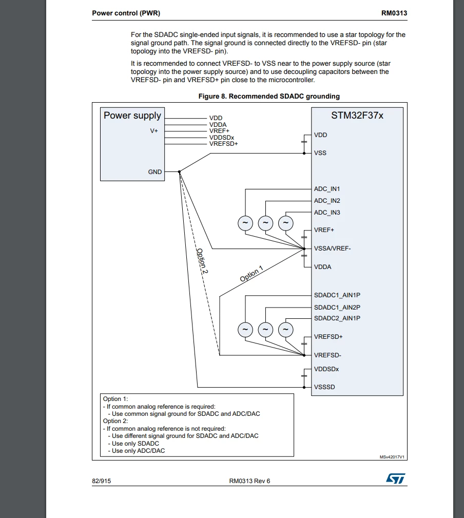

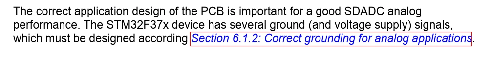

and look for optimum ground ...->
MKing.2364
May 26, 2023
Dear Ascha.3 many thanks I will read and study Section 6.1.2 Correct Grounding for Analog applications

I was just about to post the same image as Ascha, there seems to be a differential amplifier/gain stage just before the ADC, see page 233 of RM0313.
As long as your only measuring a single channel in continuous mode on each SDADC then it should be able to measure 50kHz. (which you are)
See page 240 of RM0313, section 13.5.9 for the FAST bit to enable 50khz sampling.
You should try and use STM32CubeIDE or STM32CubeMX to explore channel selection for the SDADC, there is also a dropdown for FAST conversion mode when continuous mode is enabled.
