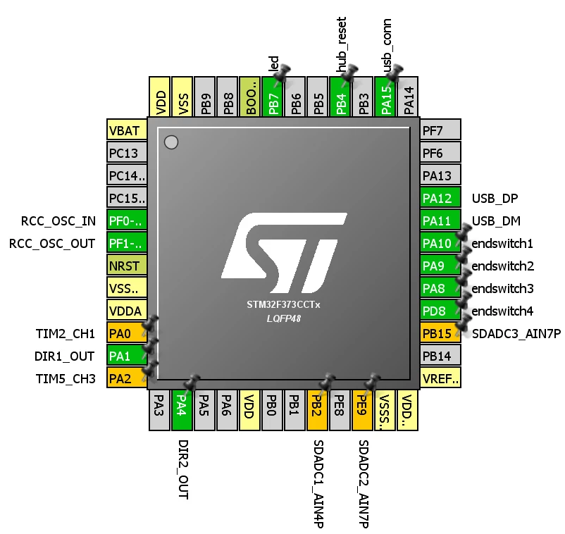

    It's a custom board? Can you show your schematic? Looks not like F373 EVAL board.
    Do you consider to refresh your library to CubeF3 1.8.0?

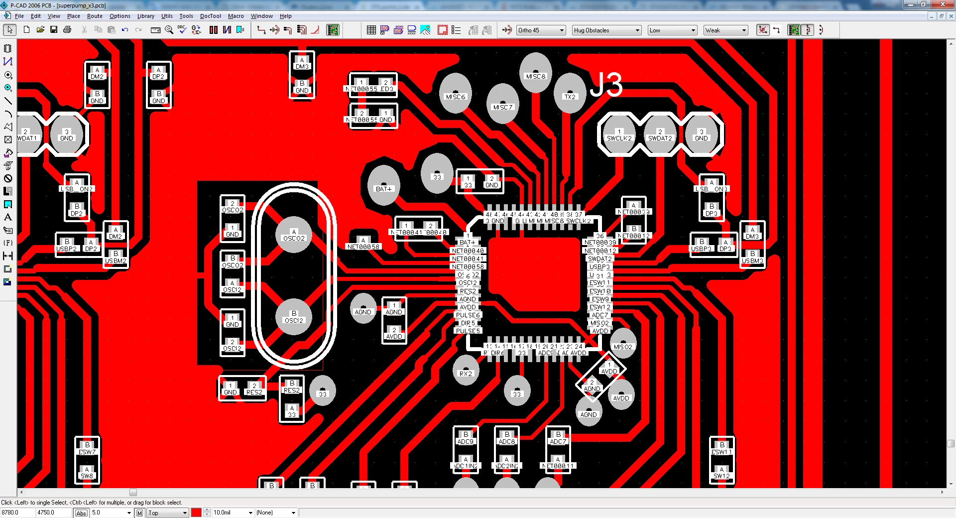

    Yes, this is my own board. I didnt make sch file because of simplicity. I draw pcb looking at CubeMX pinout.0690X00000607SVQAY.png0690X00000607REQAY.png

    Товарищ,
    It's difficult for me to understand you.
    You can layout without a schematic?
    You are using CubeMX without generating a HAL/LL project, and still using StdLibrary?
    In your project, you are still have stm32373c_eval.c without using it.
