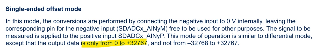

Hello Friends,
I use STM32F373 for 16-bit SADC.
I have single-ended input 0V to 3.3V. VREFSD+=3.3V and VREFSD- =0V
When input Voltage change from 0V to 3.3V I get values 0 to 32767. Is it not possible to get 16-bit (65535) data?
Always signed?
my configuration;
ConfParamStruct.InputMode = SDADC_INPUT_MODE_SE_OFFSET;
ConfParamStruct.Gain = SDADC_GAIN_1_2;
ConfParamStruct.CommonMode = SDADC_COMMON_MODE_VSSA;
Thanks a lot.

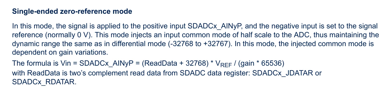

With this, values will always be 0 to 32767.
You want single ended zero reference mode instead. Not offset.
The output will still be signed, but the full range of 65535 values will be present.
July 30, 2024
Thank you very much. it worked.
