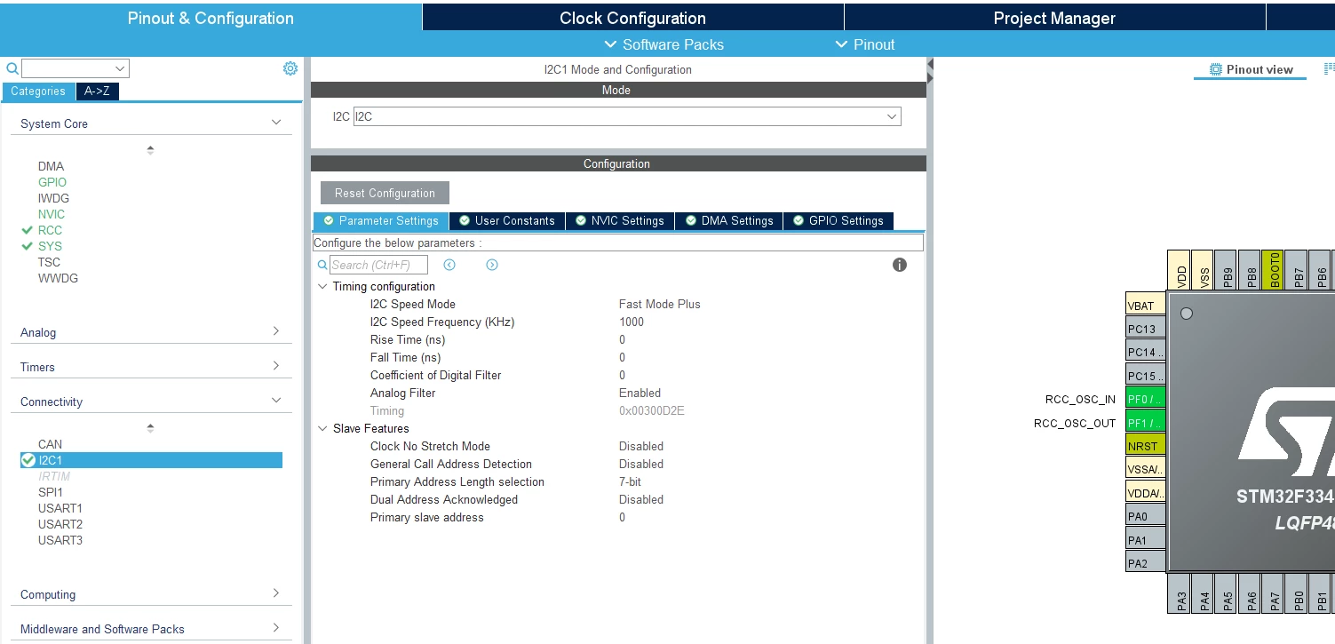

Stm32f334 i2c works in slave mode , select i2c kernel clock 72mhz.
datasheet says it's i2c fast-mode+ support up to 1mhz, but I found that it can be accessed stably by a master with scl at 2.5mhz. Is it ok to use a master scl speed faster than 1mhz to communicate with the mcu, what's the mcu's i2c scl speed limitation as a slave ?
and how "I2C timing configuration tool " can help to set the timing reg in this situation, now i set the timing reg to 0x0.

Hello @tri.1​ ,
The maximum frequency for the I2C communication is 1MHz.
"The interface is connected to the I2C bus by a data pin (SDA) and by a clock pin (SCL). It can be connected with a standard (up to 100 kHz), Fast-mode (up to 400 kHz) or Fast-mode Plus (up to 1 MHz) I2C bus." RM0364 section 27.4 I2C functional description.
>how "I2C timing configuration tool " can help to set the timing reg in this situation ?
you can use STM32CubeMX for the configuration :

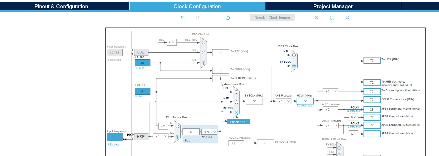

_legacyfs_online_stmicro_images_0693W00000bkxInQAI.pngyou can set 72MHz as a clock :
Hope I helped you!
