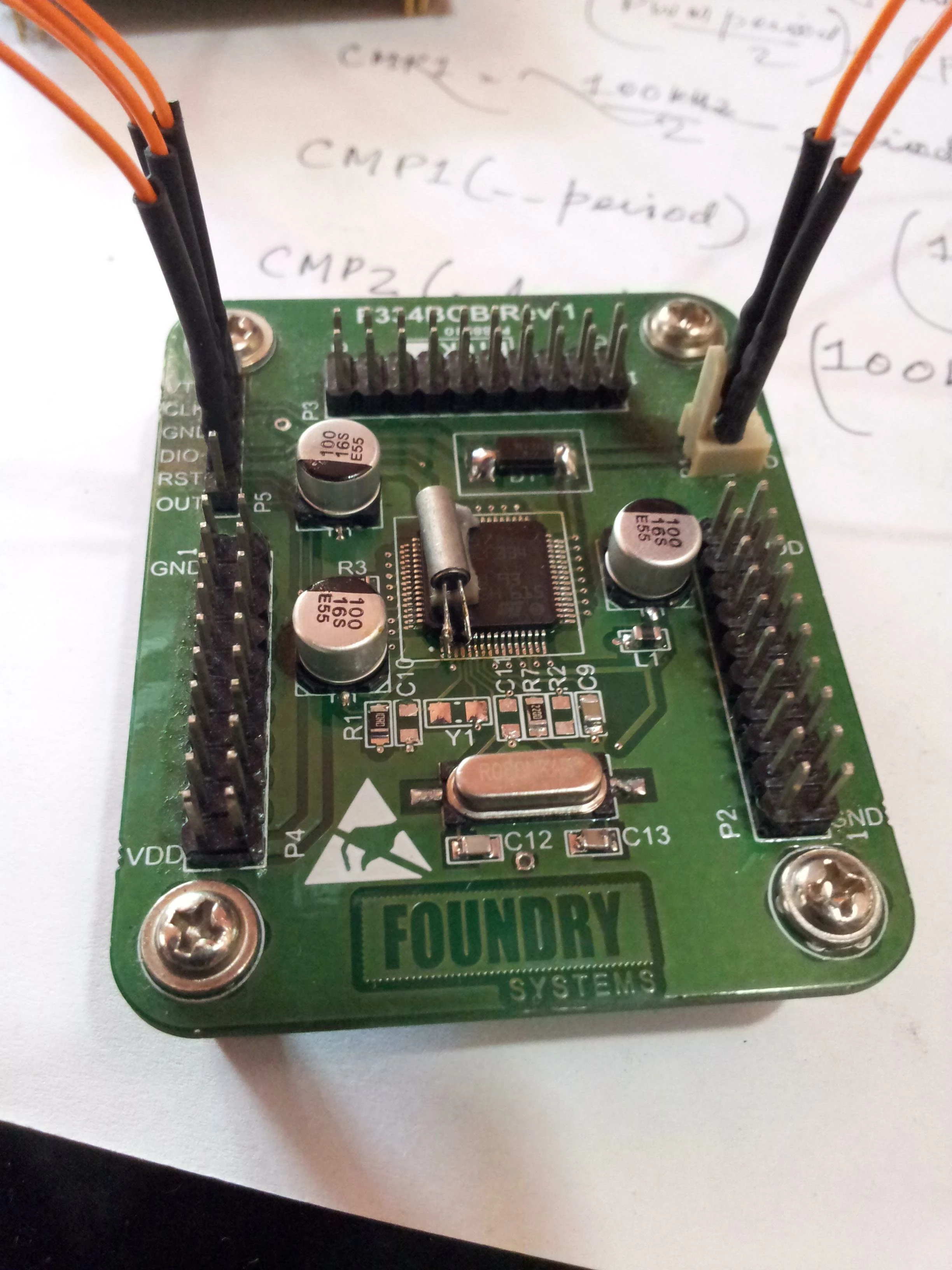

I have a STM32F334 with a cylindrical watch 32.768kHz xtal connected as a LSE oscillator. LSE now works. Folks on the forum, were kind enough to point out to me about possible PCB related issues.Originally, I've had a EPSON SMD crystal in there.
Found a multitude of problems in there after digging into the issue, the first problem was a dead 32.768kHz crystal. Many trials later, tried the same crystal connected to a HEF4060 on a veroboard to test the crystal, which verified that the crystal was dead. Tried a cylindrical watch crystal with the HEF4060 and it worked. Tried the same cylindrical crystal in the same position, which did not work at all. The PCB design issue came to my mind, eventually stuck the crystal on top of the F334 and soldered the pins directly on to the F334.
Unfortunately, this also did not help. After pulling out some hair, I found that for the LSE to be turned ON, the RTC domain had to be reset, which allowed the LSE to be turned ON.
This now works, I can turn ON the LSE, can see the MCO output as well as the RTC_CALIB_OUT.
This but raises yet another concern. Everytime, I reset the CPU, the LSE is turned OFF/ON, as a result the RTC setting gets messed up. I am wondering how to avoid the RTC getting messed up.
Any thoughts/suggestions ?
Thanks

    Seems like you reset the RTC yourself during startup in the rtc_setup() function.
    you could just put the following statement at the start of your rct_setup() function:
    if( __LSE_RDY() ) return;
    This will check if the LSE is already started, if it is, just leave it running.
    That's basically what I do, and it works without any problem.

    Manu Abraham
    Senior
    Mar 28, 2017 1:08 PM UTC
    Posted on March 28, 2017 at 13:08
    That does the trick. Verified MCO and CALIB_OUT. LSE state appears not changed until a power cycle; not affected by a RESET though. Which probably explains my other question too.. That looks like a nifty hack, not allowing LSE/RTC to change except for a power cycle. I guess I missed this behaviour while reading the datasheet. Need to re-read the data sheet, where it explains this behaviour.
    Thanks!
