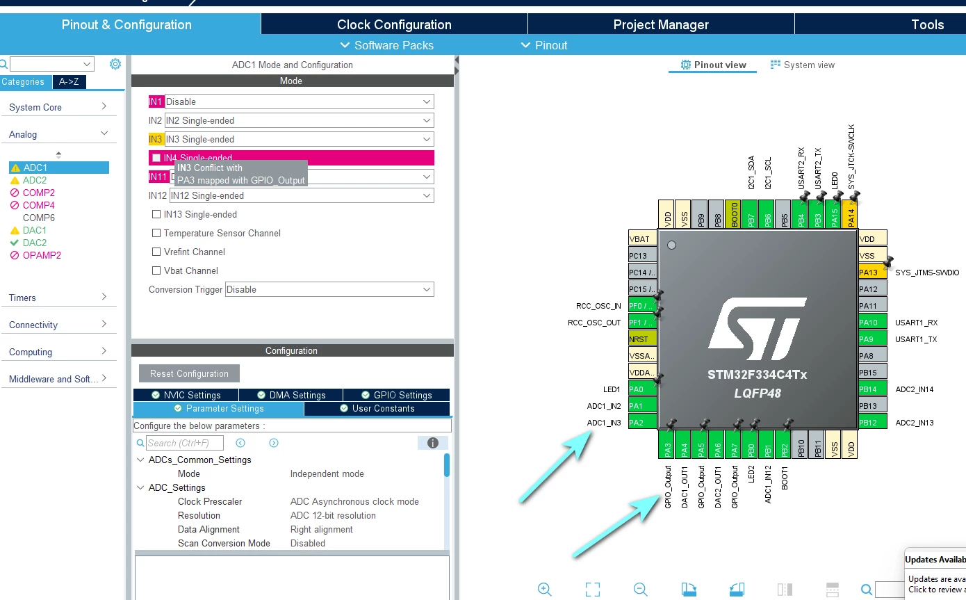

Hi all.
Why when I configure an ADC input in PA2 port, I have a conflict with another pin PA3 port that is configured as GPIO?
Many thanks.

In your screenshot, the conflict is not on IN2 - it's on IN3:
Presumably, IN3 is on PA3?
bestyengAuthor
December 5, 2024
Hi Andrew, the problem is on IN3 mapped on PA2, but the tool tell that the conflict is on PA3 that is mapped as GPIO.

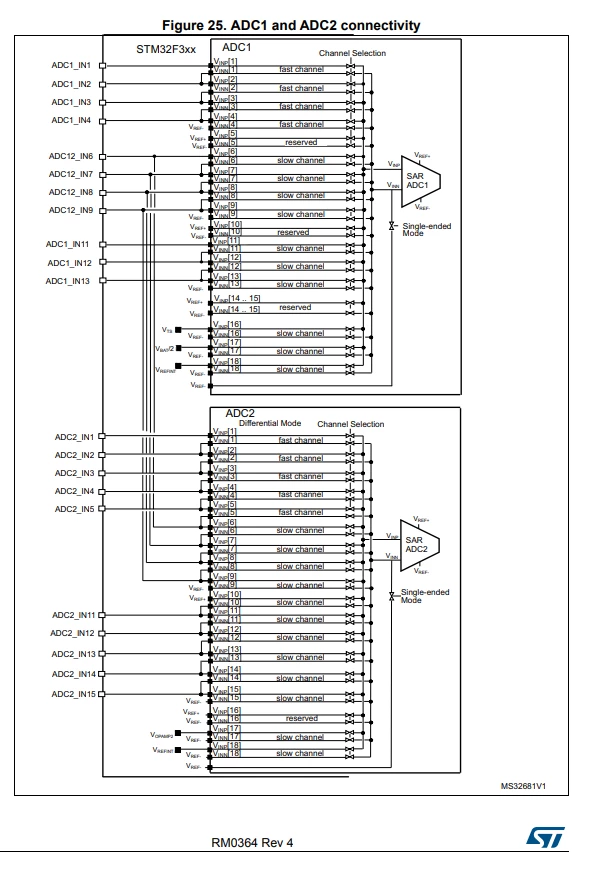

Hello @bestyeng @Andrew Neil
In your case if you want to set IN3 on the IN3 Differential, you will need to use Both PA2 ADC Positive input analog and PA3 for Negative input analog. For the single-ended mode you just need the IN3 on the PA2. You can see more about that on the following Figure 25 From the RM0364:
Best Regards.

bestyengAuthor
December 5, 2024
Ok, many thanks. So in this case single ended is only a warning, I may not consider it?
Best regards.
Ozone
Principal
December 5, 2024
If you selected single-ended and not differential, this is a bug in the Cube tool.
