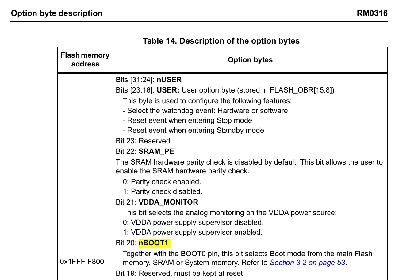

How would the BOOT1 option bit be set? I do not see a pin or specific firmware instructions for where BOOT1's option bit is located. I plan to boot from Flash memory by sending data through USB.
The nBOOT1 option bit is within the option bytes. Use STM32CubeProgrammer to set the option bytes. Connect and select the "OB" tab.
