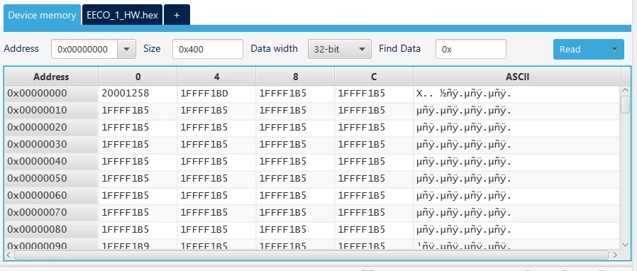

I see the following data in the flash at location 0x0000 0000 when read with CubeProgrammer:
Shouldn't 0x04-0x07 contain the program start address of 0x0800 0000 + vector table size?
Is the flash is read protected and I am looking at invalid data?

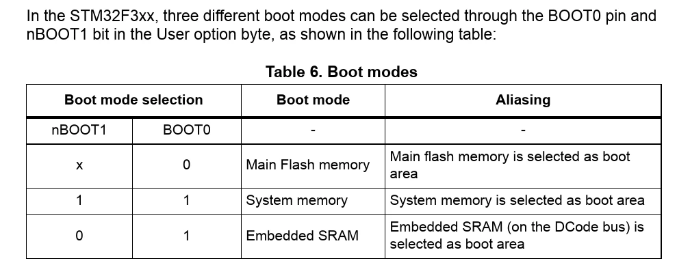

what is state of boot0 pin , gnd ?
(0x1ffffxxx looks like jump to system/bootloader...)

Examine option bytes which might be hard-wiring it to start into the system bootloader.
AN2606 will list all possible patterns which can cause it to run the bootloader rather than system flash. Certainly seems like you're in there, so might be worth running through all possible scenarios.

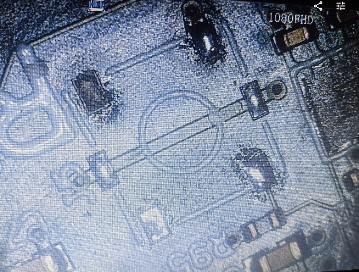

@AScha.3 - Thanks, I was incorrect RE the BOOT0 resistor:
I have verified logic low on the Boot0 input. I am not sure soldering to GND will make any difference here.
jlagAuthor
Mar 9, 2024 5:29 AM UTC
It turned out to be a HW issue that @AScha.3  made me investigate further. The switch on the board for BOOT0 high/low was mounted incorrectly and caused BOOT0 to be logic 1 for this particular board.
There was no other electrical way to get BOOT0 to logic 0 other than removing the BOOT0 selection switch from the PCB:
Bye bye switchie:
Removed boot selection switch from the PCB and all is well. I was thinking this was way worse than it was (clock chasing, etc.).
