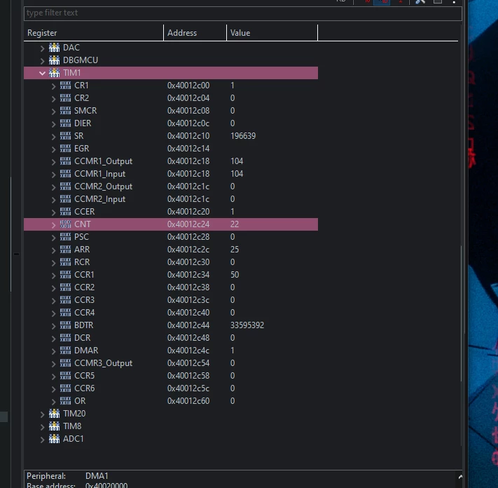

samsamm777
August 31, 2022
0693W00000SuDBaQAN.pngIve found the TIM1 registers. This shows the values during runtime. This setup is currently just giving a HIGH signal on the output.
waclawek.jan
waclawek.janBest answer
August 31, 2022
CCR1 > ARR, i.e. CNT never reaches CCR1 thus can't "compare match" thus change output level.
PS. Generally it's more useful to display registers in hexadecimal.
samsamm777
August 31, 2022
Ah! so CCR isnt a percent. I was imagining it as the duty cycle percentage. But its not, its purely a count. So I need to calculate the value as a percentage of ARR.
