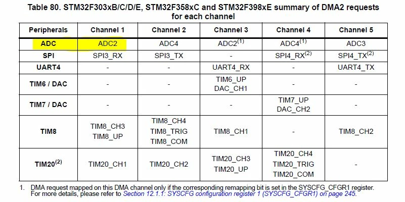

Posted on February 12, 2018 at 16:09
Hi
I am trying to develop a project via the STM32F303RE Nucle Board. In the project, I need to read analog data from channel 0 (PA4) on the ADC2 hardware.  For this I made an init code.

  /* DMA configuration */
  /* DMA2 Channel1 Init Test */
  DMA_InitStructure.DMA_PeripheralBaseAddr = (uint32_t)&ADC2->DR;
  DMA_InitStructure.DMA_MemoryBaseAddr = (uint32_t)&ADCConvertedValue;
  DMA_InitStructure.DMA_DIR = DMA_DIR_PeripheralSRC;
  DMA_InitStructure.DMA_BufferSize = 1;
  DMA_InitStructure.DMA_PeripheralInc = DMA_PeripheralInc_Disable;
  DMA_InitStructure.DMA_MemoryInc = DMA_MemoryInc_Disable;
  DMA_InitStructure.DMA_PeripheralDataSize = DMA_PeripheralDataSize_HalfWord;
  DMA_InitStructure.DMA_MemoryDataSize = DMA_MemoryDataSize_HalfWord;
  DMA_InitStructure.DMA_Mode = DMA_Mode_Circular;
  DMA_InitStructure.DMA_Priority = DMA_Priority_Medium;
  DMA_InitStructure.DMA_M2M = DMA_M2M_Disable;
  DMA_Init(DMA2_Channel1, &DMA_InitStructure);

When I run these codes I can't read adc.  I ran the same codes with ADC1 and DMA1. But ADC2 and DMA2 do not work.
Is there something I'm missing? Why does not work?
    Nothing jumping out immediately. Code not compilable/complete.
    Probe DMA, ADC in Peripheral View mode, inspect registers, see if errors flagging, addresses as expected.

    in Debug Mode, I see the ADC2->DR register. This register always appears to be zero. I guess the ADC2 hardware is not working. I don't understand what the problem is.
    What is missing in the code? The ADC1 Hardware is working in the same way. But ADC2 is not working.

    But I am running ADC with Single ended Mode.What is the difference between ADC1 and ADC2?Because the same codes work with ADC1.But ADC1 does not match any channel PA4.

    When I watch the ADC2 registers with Debug, I see thatADC2->DR Register always Zero.Is there a configuration code with ADC2?
    Really ?
      ADC_CommonInitStructure.ADC_Mode =
    ADC_Mode_Interleave
