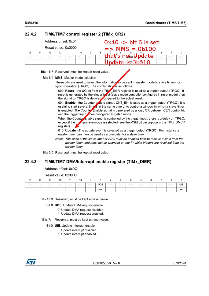

TIM6->CR2 = 0x00000040
Also, as @TDK said above, for more correct timing, you want to set DMA *not* to be triggered from TIM6 (i.e. clear TIM6_DIER.UDE), but from DAC1 (for which you need to set the remap pin in SYSCFG).
As it is now, it should work too, but then - again for correctness - switch off the DMA request from DAC.
