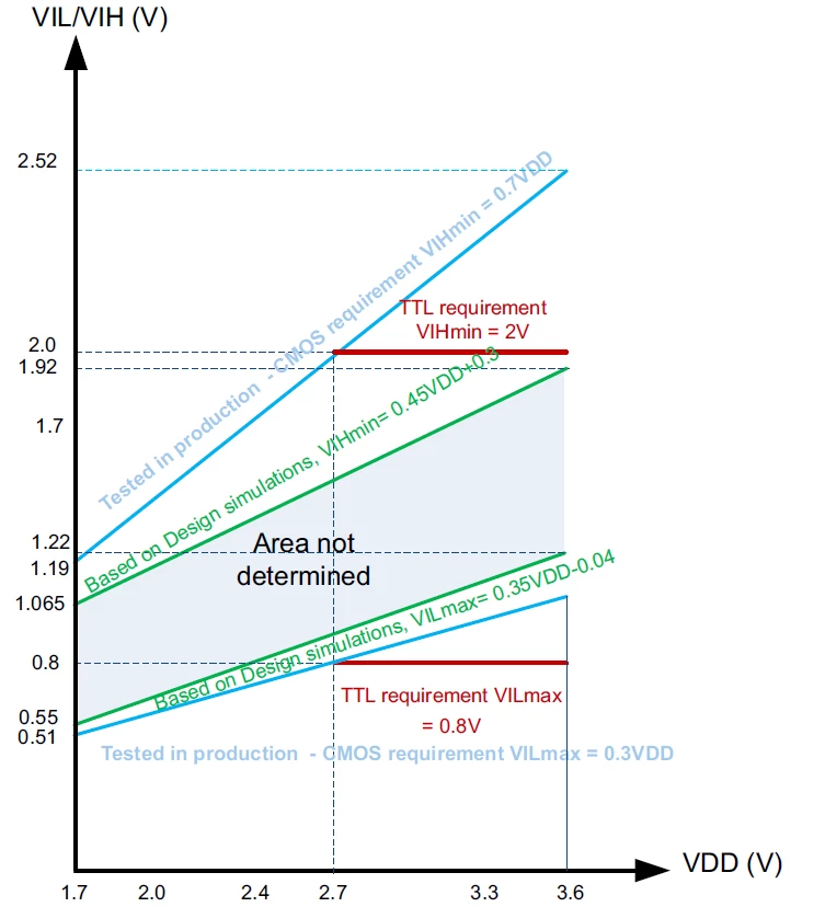

Data sheet for STM32F303 Vih specification indicates;
1. TC and TTa I/O = 0.445*VDD + 0.398
2.  FT and FTf  I/O =  0.5*VDD  + 0.2
3.  All I/Os except BOOT0 = 0.7*VDD.
Item 3 seems to contradict  1 and 2. Can this be clarified?
    2 replies
    waclawek.jan
    July 26, 2017
    Posted on July 26, 2017 at 07:34
    The footnote says it: 1 and 2 are based on simulations, 3 is the value against which the ports are tested in production.
    STOne-32
    July 26, 2017
    Posted on July 26, 2017 at 21:24
    Dears,
    we confirm it. There is no contradiction.  we test all our devices at factory before we ship to customers at  0.7*VDD; However we give design guidelines based on simulations and so we relax a bit the worst case testing. It is a matter of Guarantee we provide to end customers.
    Here is a picture for illustration on STM32F4 series, but similar as other products to understand what means the Guarantee we provide.
    Cheers,
    STOne-32
