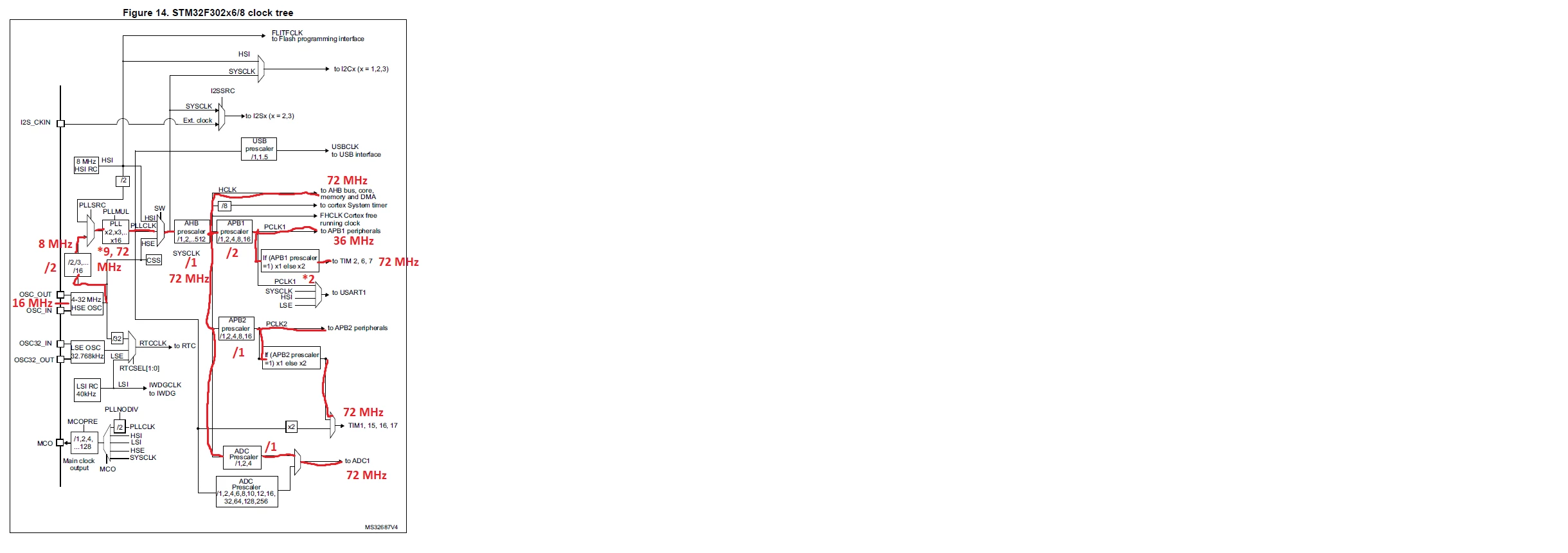

STM32F302R8 TImer 6 Clock Speed / Time BAse
HI,
So I cannot seem to get the time base that I expect out of Timer 6. I have got timer working wiht the right freqnecy however I cannot seem to get timer 6 to work at the expected freqency. It seems to be running twice as fast to what I set it to.
I am running a 16 MHz internal, in the diagram attached you should find the rest of the RCC settings.
This is the code that goes with that diagram. I have checked it and it should all be good but maybe I missed something.

waclawek.jan
waclawek.janBest answer
Jan 1, 2021 10:42 PM UTC
This is probably the late interrupt clear problem. Move
> TIM6->SR = ~TIM_SR_UIF; // Clear interrupt
to the beginning of the ISR.

glenn0010
glenn0010Author
Jan 2, 2021 10:02 AM UTC
Thanks to both of you for your help.
Jan, you were spot on. I am clearing the interrupt flag first thing in the ISR adn this fixed my issue.
Nice to know of this little quirk
Cheers
