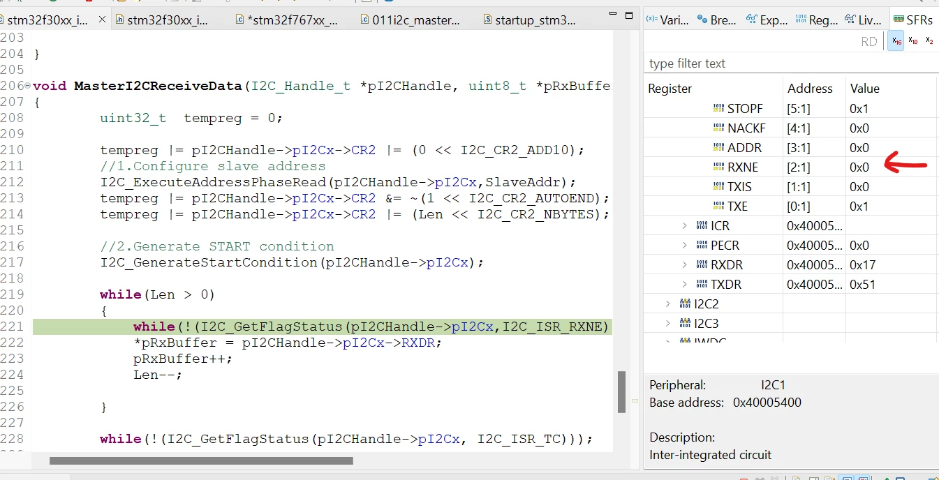

Im using STM32F302R8 and developing the driver for I2CMasterReceive data from Arduino.
Here is my problem:

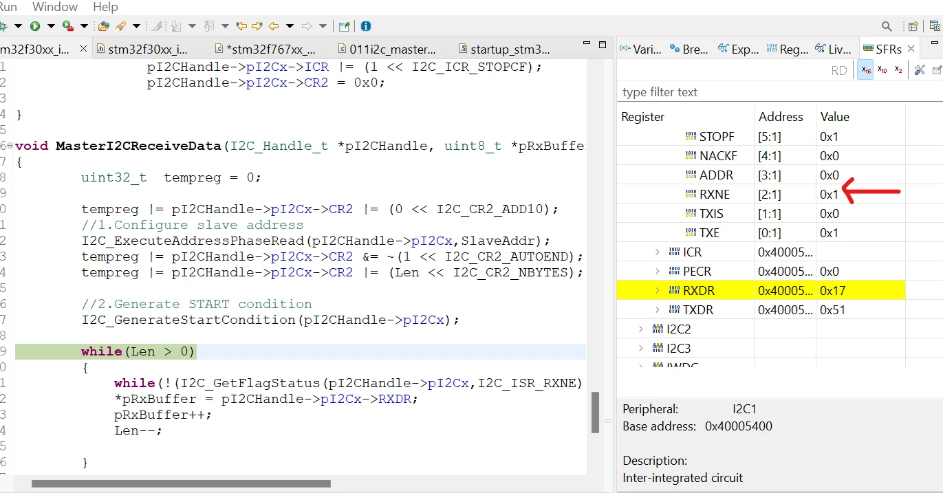

_legacyfs_online_stmicro_images_0693W00000biAUCQA2.pngAfter I send a command code, from master 0x51, and generate the start condition, the RXNE is SET.
But, after it goes into the while loop, the RXNE suddenly RESET. I do not read yet the RXDR register.
I do not know why this problem happen. Could anyone help me?

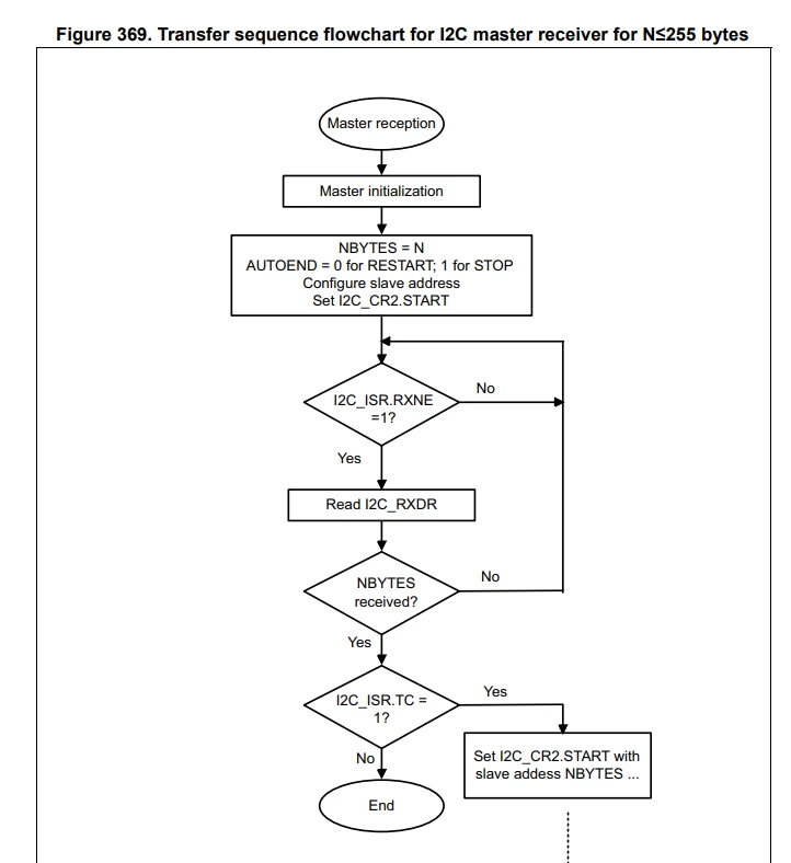

WM_IRAuthor
April 17, 2023
After I try to understand, isn't your code is for the STM32 become slave? Actually, Im working on the STM32 as Master, but it received data from the slave. Which can refer here:
