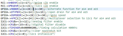

stm32f302r8 i2c problem
0693W00000aIrAJQA0.pnghello i am working with i2c i used register for coding i2c but when i configure AFRH register i cant upload my code to my board i have target not responding error then i tried hal library but nothing changed

This is because PA14 is used by the debugger (SWCLK). Don't touch it if you download the program over the debugger.

hi thank you so much
