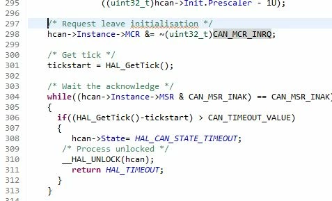

    I apologize for the delay in responding, but I wanted to make sure I tried all the suggestions. At this point, I have built a new project and implemented all the code from the STM32F303C_Eval example project. I debugged, and found the
    point that the code is failing. The code in the image below is from the stm32f3xx_hal_msp.c file. It is in the CAN_Init function.
    On line 297, it puts out a call for a response, then waits for an acknowledgement on line 304. It never gets that bit set, even when I connect to a known working bus. I have two other devices communicating without error, and just listening for something from the nucleo.

    There are several primary issues for the hardware BxCAN;
    The RxCAN pin, needs a pullup,
           the internal pullup on the processor pin is good enough.  <- this will stop your code at initialisation.
          where is that problem bit, ABOM .. it needs to be set.      <- this will look like no packets received*
    Then the filters, befuddled in gobbledygook left bewildered we are.
    there are two concepts for filters
    1. bits can be ignored, in this example only the 2 bits are checked
            sFilterConfig.FilterMaskIdHigh    = 0x300 << 5;            //11-bit ID  in top bits
            This register sets the filtering on only 2 bits. 011 0000 0000 <- mask for pattern match
    2. bits must be set in a pattern, in this example, if those 2 bits don't match, the filter will ignore the packet.
            sFilterConfig.FilterIdHigh = 0x100 << 5;
            the only pattern allowed here is                     001 0000 0000
    address ranges that will match:
    0x0100 - 0x01FF
    0x0500 - 0x05FF
    other than that, ISOLATED CANBUS for long hauls, to alleviate the ground noise spikes.
    Marshal Haupt
    July 23, 2017
    Posted on July 24, 2017 at 01:50
    Thank you everyone for your suggestions. I was able to recreate the code that Joe provided above and get it to run. Essentially the only difference is the removal of the additional USART that gets added automatically in MXCube for the Nucleo board. I will have to figure out if this was the problem or not eventually, but if anyone knows why this could be, it would help. Thank you, again.
