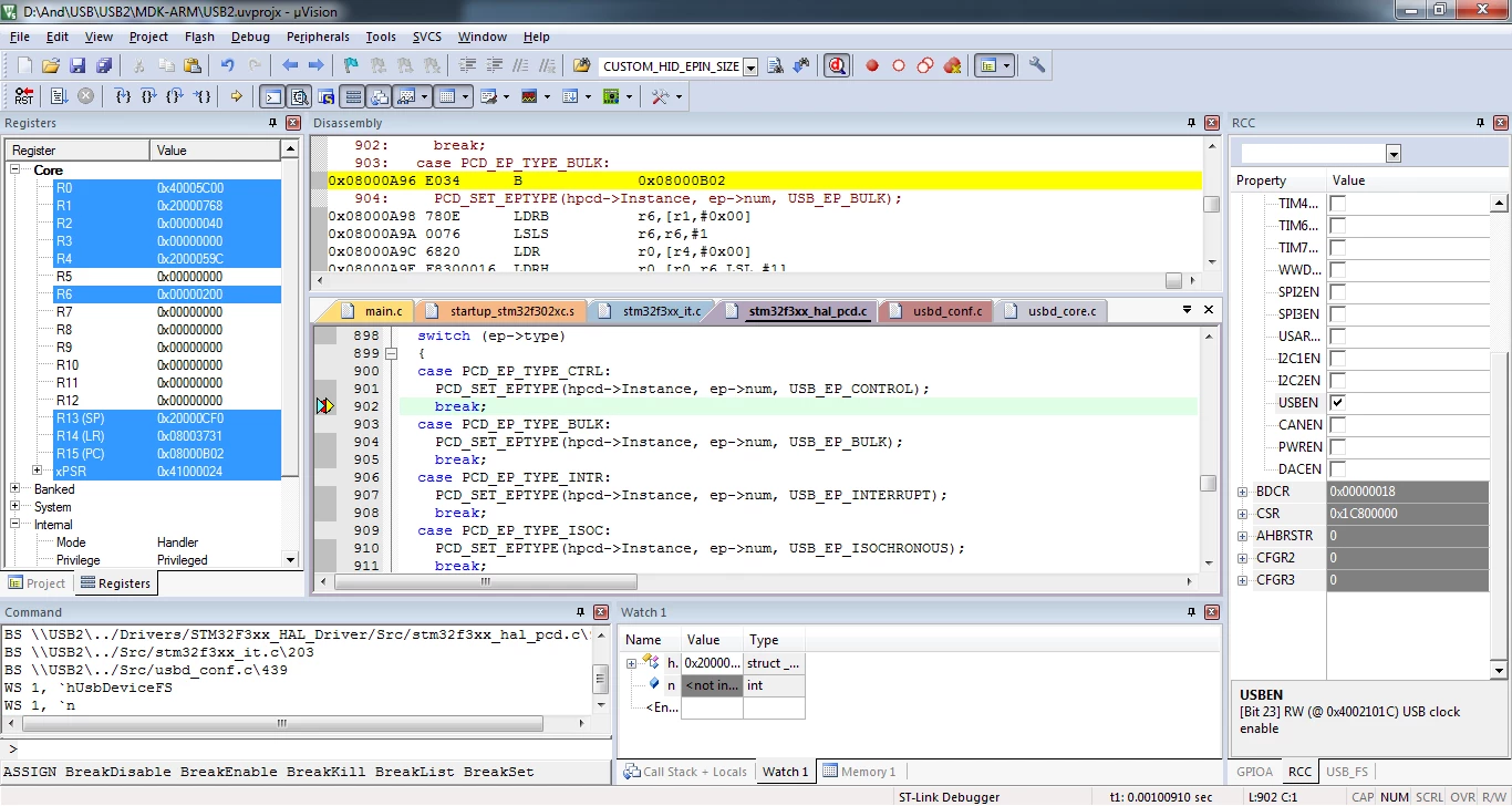

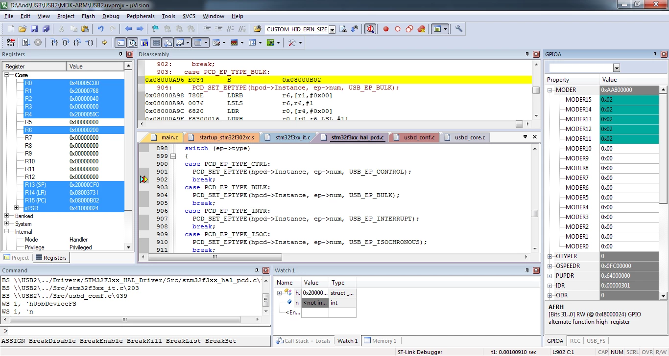

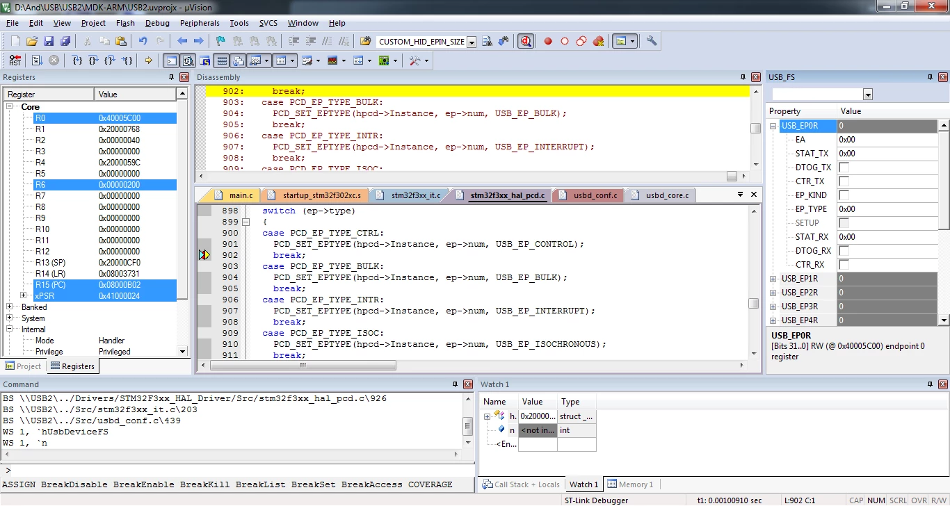

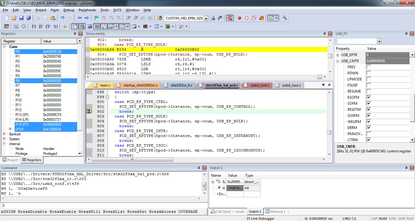

I'm trying make USB custom HID with stm32f302CB. I'm using Keil v5.23 and STM32CubeMX. The problem:
PC just don't recognize the USB, when i running in debug mode i saw something strange. Just after calling HAL_PCD_Init interrupt executing. In HAL_PCD_IRQHandler from there we go to HAL_PCD_ResetCallback. Thet calbek must config USB_EP0R register to config default endpoint. It perform by HAL_PCD_EP_Open. Ther are macros PCD_SET_EPTYPE thet write in USB_EPnR  but in peripheral viewer they doesnt change. It's strange because others USB registers are writing normally. I'm trying write UART_EP0R by my own but it's doesn't work either. In RCC_APB1ENR USBEN is set.
0690X0000060ARLQA2.png0690X0000060ARQQA2.png0690X0000060ARVQA2.png0690X0000060ARpQAM.png
Im trying to create same USB HID on STM32F407 Discovery with Keil and CubeMX and it works fine.
Does someone have an idea where the problem could be?

    I find my problem. I was using some non recommended crystal ceramic resonator. Interesting that crystal ceramic resonator was generate swings and even my UART working on defined frequency. I think there was little frequency deviation and it was acceptable for UART but too big for USB.
    Look into the RM - some bits in this registers are rc_w0, which means you cannot write them to 1; others are t, which means that writing 0 has no effect and writing 1 toggles its value.
    Your problem will be most probably somewhere else.

    Thanks for You'r advise but in reference manual in registers USB_EPnR are two rw bits EP TYPE that I traying to set, and it's doesnt work.

    I know it's not in the RM, but I guess those bits are locked when the channel is enabled.
