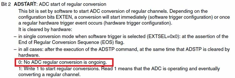

I am trying to get the ADC working on a STM32F302 processor and I am noticing while single stepping the code is when I call�? HAL_StatusTypeDef HAL_ADC_Start(ADC_HandleTypeDef* hadc)�? and exercise the code the “CR''Register never changes:
if (__HAL_ADC_NONMULTIMODE_OR_MULTIMODEMASTER(hadc) )
hadc->Instance->CR |= ADC_CR_ADSTART;
I have read the manual and it states if the ADEN = 1 and the ADDIS = 0 and there are no pending ADC disable the bit should set.
Currently ADEN = 1 and ADDIS = 0, but I don’t see the value updated.

Well it's not a memory cell, is it possible that it auto-resets once the conversion completes, and that's a fraction of the time the debugger will take.
Also if you have the debugger peripheral view parked over the ADC, and it reads the data register, this will likely impact other registers/status

I think you are seeing this bit set to 0 because the conversion is done quickly, this is already mentionned in the reference manual when no regular conversion is ongoing this bit is set to 0.
In order to see this bit status try to slow down your system, and also the ADC by putting smallest sample time and try to poll on this pit.

Heisenberg I was wrong. I wrote some test code and captured the ADSTART and EOC being set and cleared very quickly. So with that information I now am trying to understand the EOC. My code is based off an example from ''
STM32Cube_FW_F3_V1.0.0 -ADC_Sequencer''
From my understanding the software to trigger the ADC calls:
TestTemp1 = HAL_ADC_Start(&hadc1);
//* Wait for conversion completion before conditional check hereafter */
TestTemp2 = HAL_ADC_PollForConversion(&hadc1, 10);
The “HAL_ADC_Start(&hadc1)�? returns HAL_OK, but the “HAL_ADC_PollForConversion(&hadc1, 10)�? returns HAL_ERROR(HAL_ADC_STATE_TIMEOUT). The error is due to the checking of EOC and EOS flags, which by this time are cleared so I am timing out
Below is the code that is timing out code from the HAL ADC polling routine. I am assuming from the example code the EOC should still be set, but seems to be getting cleared by the DMA reading the DR register is my guess, so I am not sure what I should be doing.

When you use the ADC + DMA, then you use the DMA HT/TC interrupts to indicate the End-Of-Conversion for the block of data read.
Yes the DMA reading ADC->DR will clear the EOC, as will sitting the debugger over the ADC peripheral presenting you the register content. The ADC's EOC triggers the DMA transfer, which is going to occur a lot quicker than you're ever going to be able to react to it. Figure an interrupt will eat about 12 processor cycles just preserving state before even entering the IRQHandler.
