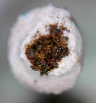

    franck23
    franck23Author
    May 30, 2017 4:33 AM UTC
    Posted on May 30, 2017 at 06:33
    Hi Clive,
    Yes, that was the hardware!
    It is what happens when you buy cheap pre-crimped wire for testing. One of the wires had rusty iron instead of copper...
    The code on the first post works fine.
    I have attached a close look of the wire below...
