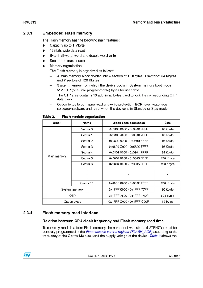

I am porting some code from stm32f105 to stm32f205.
  1. stm32f105´s memory is erased in 64 pages of 2kbytes (i can handle this)
  2. stm32f205´s memory is erased in 12 sectors of 42kbytes!!? (flash size is 512kB)
(from stm32f2xx_hal_flash_ex.h)

am i missing something here?
this is very incovenient because i dont have enough ram to copy in a table the part of the sector i dont want to be erased before erasing it.

waclawek.jan
Apr 7, 2021 10:36 AM UTC
The 'F2 (and 'F4) FLASH is partitioned into non-uniform sectors. See RM.
0693W000008yrvMQAQ.png> this is very incovenient
Yes, it is, but that's the price you pay for large FLASH on smaller piece of silicon.

waclawek.jan
Apr 7, 2021 12:45 PM UTC
> It's a little trickier when you want to use the flash as eeprom to store settings, but can be done.
> Choose a page with a size that can fit into your ram, you need to copy the page into it, because to store new data you must first erase it.
I personally prefer using two sectors for this purpose - one holds data while the other is being erased.
This, of course, is application dependent. You may also consider using the BKPSRAM with battery, external serial EEPROM/FRAM/FLASH...
