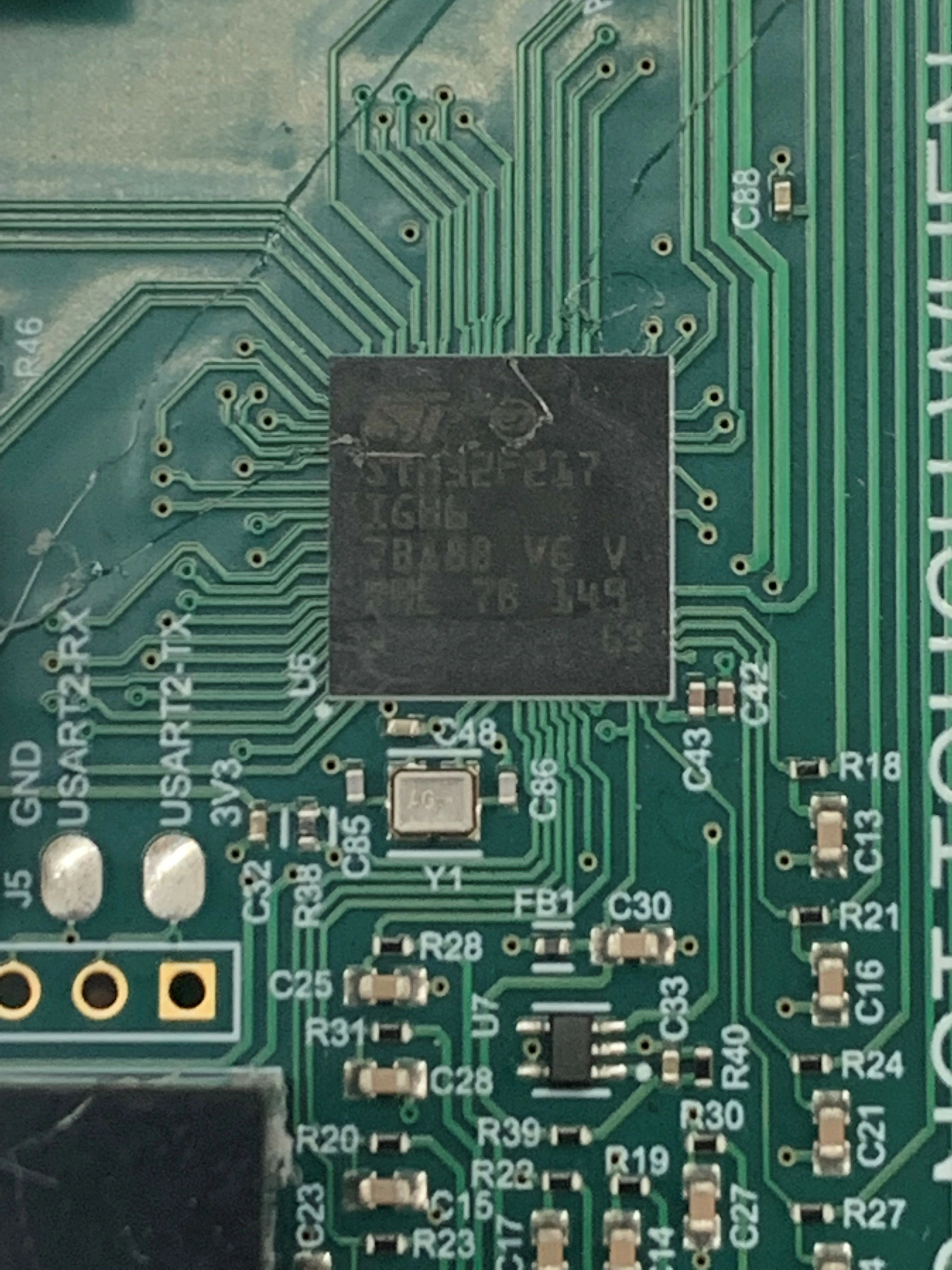

I have some ST Micro Chips STM32F217IGH6 And I am trying to validate the date code of them. Can anyone assist?

The date code is in the format YWW, here 149, i.e. 2021, week 49.
Theoretically, it could also be 2011, but the Chip Revision V came after that.
Does it answer your question?
