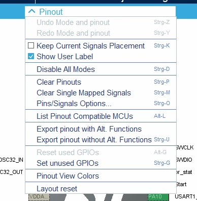

STTwo-32
Jan 7, 2025 8:08 AM UTC
Hello @rndkd1
For the pinout Compatibility, i suggest you to create a project based on you STM32F2 MCU on the STM32CubeMX. Then, use the generator of the list of pinout compatible that will give you a list of MCU that are compatible with your original one:
Best Regards.
STTwo-32
rndkd1
rndkd1Author
Jan 7, 2025 8:35 AM UTC
I generated the list, and I found STM32F407ZG in it.
But What I’m wondering is whether it is compatible across various applications, not just for a specific project.
I’m currently working on several projects, some of which use Ethernet, others use FSMC, etc.
