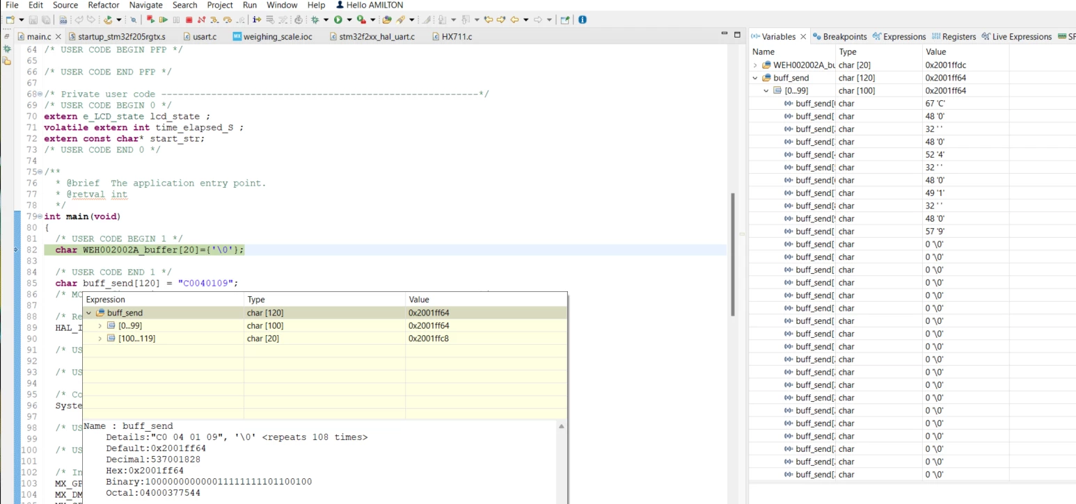

I think you miss the point, this stuff isn't sent as ASCII characters with spaces
uint8_t data[] = { 0xC0,0x040,0x01,0x09 };
HAL_UART_Transmit(huart, data, sizeof(data), 500);

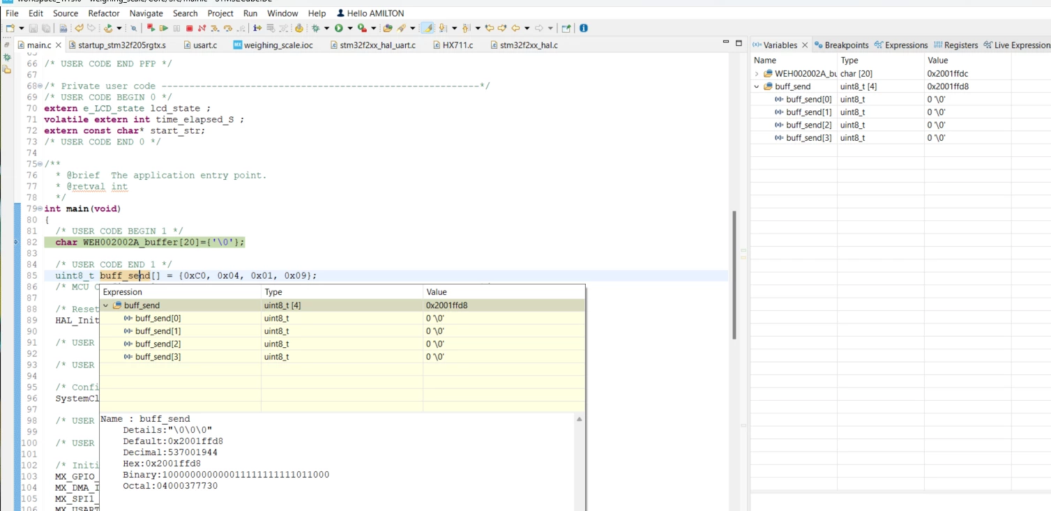

Firstly, thank you very much for taking the time to respond to my query and for your suggestion regarding the byte-oriented data transmission. I followed your advice and adjusted my code to send the command "C0 04 01 09" as a byte array directly:
uint8_t buff_send[] = {0xC0, 0x04, 0x01, 0x09};
HAL_UART_Transmit(&huart2, buff_send, sizeof(buff_send), 1000);
Unfortunately, I'm still facing issues with the LoRa module not recognizing the command. Here's what I've done following your suggestion:
  1. Verified UART Configuration: Checked that the baud rate and other settings are aligned on both the STM32 and the LoRa module.
  2. Checked Physical Connections: Ensured that the TX and RX connections are correct and secure.
  3. Used Debugging Tools: I employed a logic analyzer to monitor the data being transmitted. The data appears correct at the transmission point.
