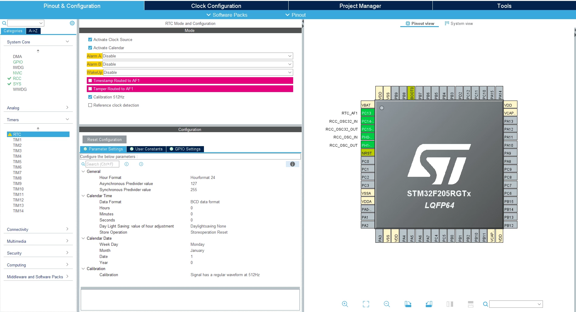

The problem is after like 4 hours of run rtc is ahead approx 2 seconds or more. How to solve this problem ?
The calibration output on pin PC13 gives me perfect 512 Hz wave as i have verified on oscilloscope. The same code is running prefectly fine on NUCLEO-F207ZG board.

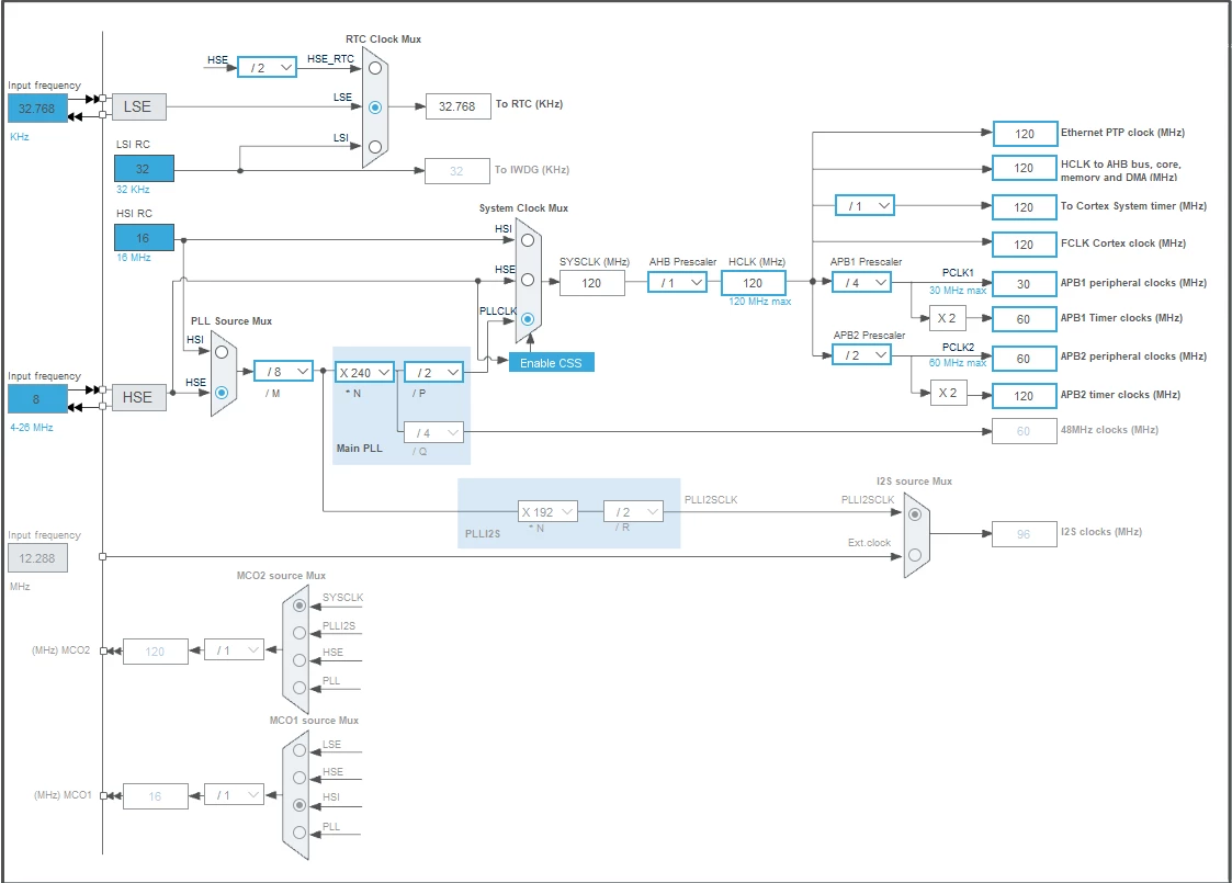

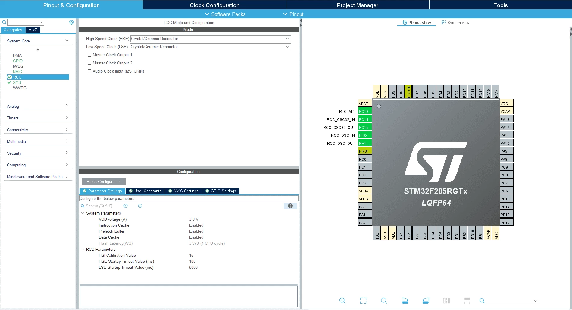

Greetings Tesla,
I have used cube for code initialization. I am attaching the screen shots of the cube for better understanding.Screen 1.pngScreen 2.pngScreen 3.png
