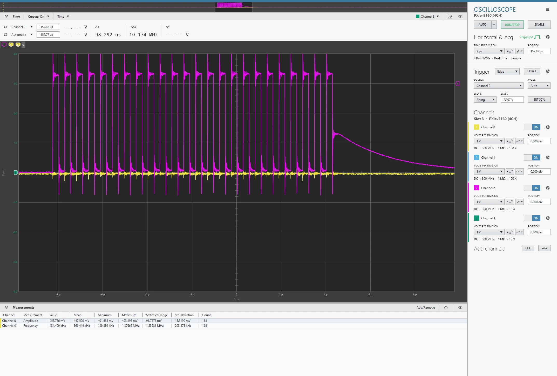

STM32F205 SPI1 in master mode, why is clock left floating at end of transfer?
Using HAL_SPI_Recieve(), SPI1 Master, 8-bit transfer, 3 consecutive bytes. At end of 24th clock pulse, the pin bounces up to a middle voltage and then decays to zero. Pull down resistor helps, but not enough. Screenshot of problem attached. How do I fix this? / Why is it happening?
Note, also using SPI3 in an identical way and this does not happen. Only SPI1. (SPI2 is busy with other things and I can't really test whether this happens on SPI2.)

This behavior is a byproduct of the awkward way receive only master mode is implemented in hardware.
Use HAL_SPI_TransmitReceive instead and leave the MOSI pin uninitialized.
Because you use Cube/HAL function, which disables SPI after end of transfer.
That explains the decay. I don't know what's the cause of the "bouncing up", but I'm not going to investigate Cube code.
Who knows what you do in combination with Cube's code.

TDKBest answer
May 24, 2021 4:37 PM UTC
GGatl.1
GGatl.1Author
May 24, 2021 5:01 PM UTC
Awesome! Works perfectly. Thank you
