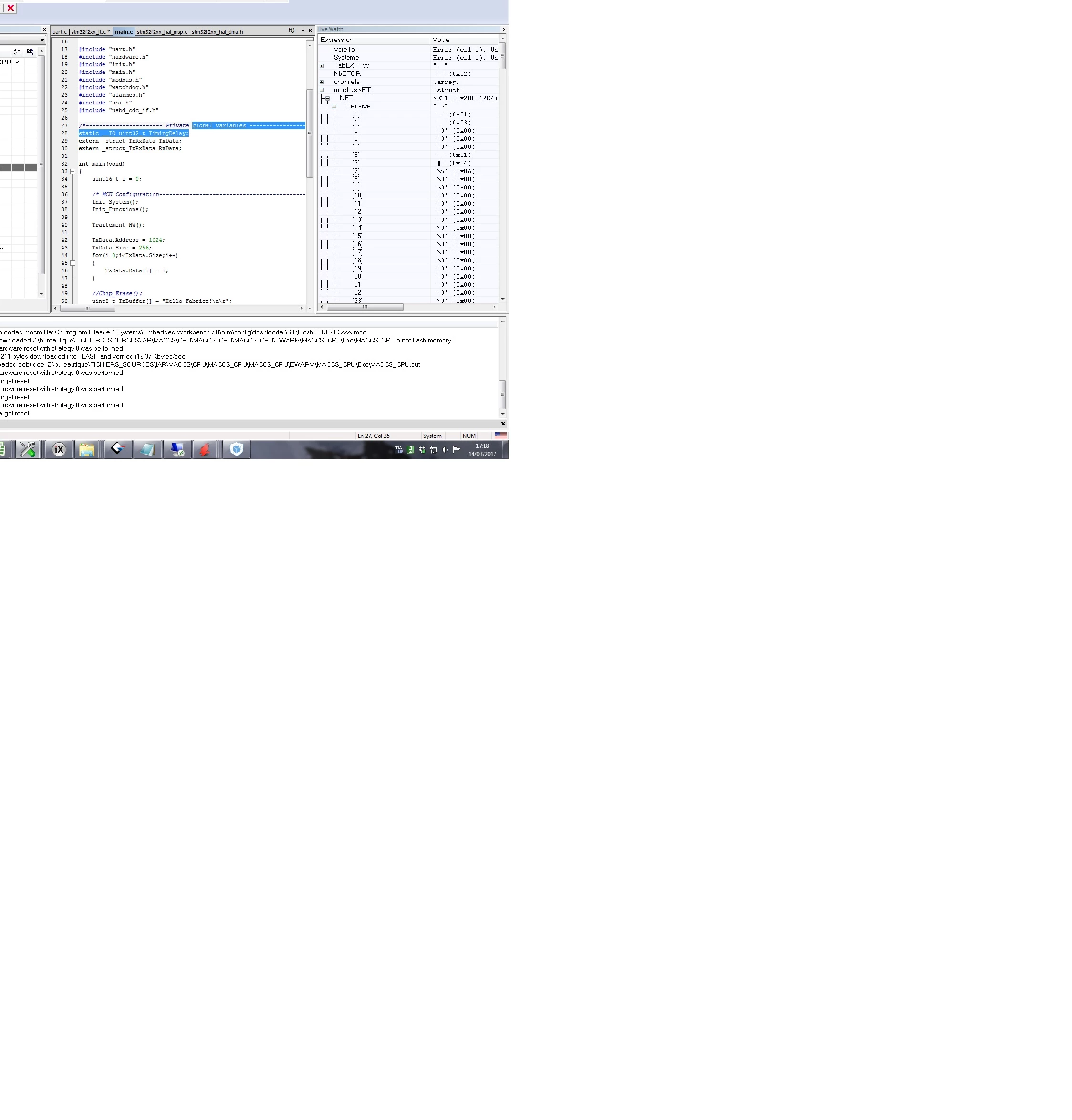

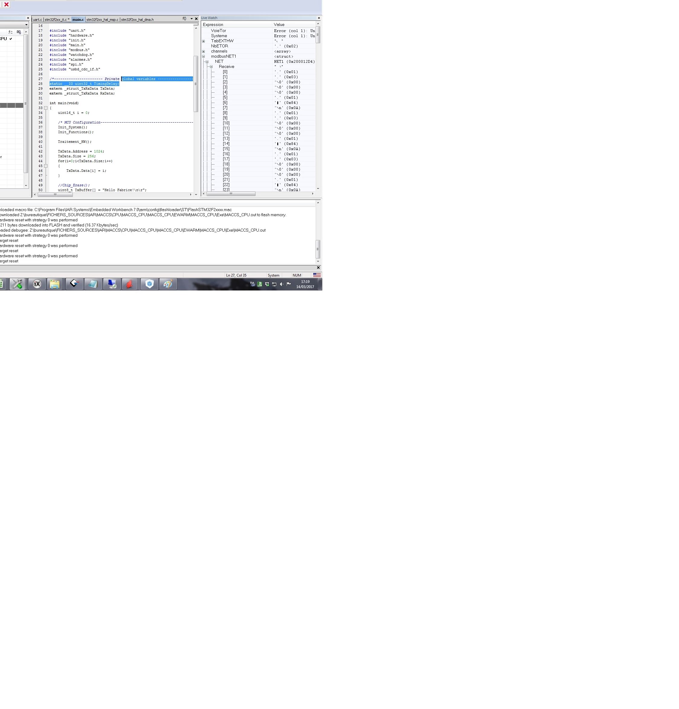

Hi Everybody,
I'm using a STM32f205RG on a personnal electronic board. I would like to communicate with an external equipment using modbus RTU on RS485 link. So, I'm trying to implement USART 1 with DMA.
For the moment, I have set everything (DMA, UART...). My board is the slave. So, I can see frames from the master (read holding registers). These frame have only 8 bytes.
So, at the first frame, the 8 bytes are located in my array from 0 to 7. When I receive the second frame, this one is located from 8 to 15.
So when I calculate the size of my frame, I found 16 instead of 8, and then my checksum is wrong, and the frame is not validated.
So, I'm looking for a solution to 'reset' this array.
Please find my code :
