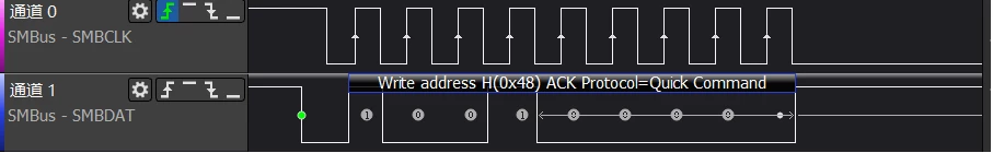

my smbus device is a temperature sensor (TMP100).MCU is STM32F103RBT6
when i wrote a word to slave as following:
I2C_GenerateSTART(SMBus_NAME, ENABLE);
while(!I2C_CheckEvent(I2C2,I2C_
I2C_Send7bitAddress(SMBus_NAME, slaveAddr, I2C_Direction_Transmitter);
while(!I2C_CheckEvent(I2C2,I2C_EVENT_MASTER_TRANSMITTER_MODE_SELECTED)){;}
I2C_SendData(I2C2,addr);// device registor address
the registor I2C2->SR1 : 0x4400. due to the smbus line nack.. how to solve it?

Hi, what is the configured bus speed?
Do you have a scope to observe the SMBUS line?
The nack can be anything, best if you can use a scope or at least logic analyzer to observe.
BR,
J
January 10, 2022
If the slave does not ACK, there is likely a hardware issue and/or you are using the incorrect slave address. Your code doesn't contain enough information to determine the latter. Note that slave addresses should be left-aligned.

0693W00000HrAyPQAV.pngI recheck my slave address 0x48, as TDK said the slave address left-aligned(0x90). smbus clock is 100khz. I2C_SendData(I2C2,addr) failed, the smbdata line sholud be low,but no changes.

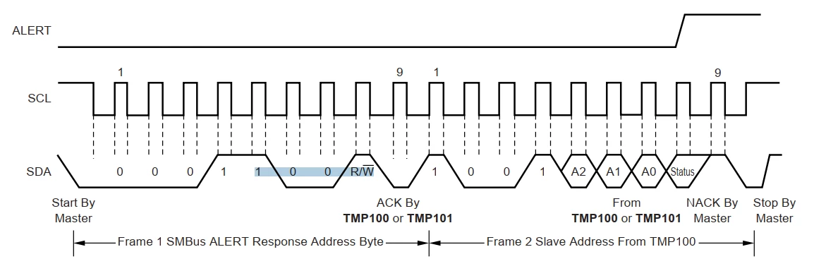

hi ,
about the SMBus Alert response , gotta dizzy. could u tell the timing? as the smbhost send 0x18 or 0x19 gotta no ack
Jseyn.1
Jseyn.1Author
January 26, 2022
Hey,
Thankyou for the slience, i gotta it.
smhost to request the slave addres & status when the alert pin active.
