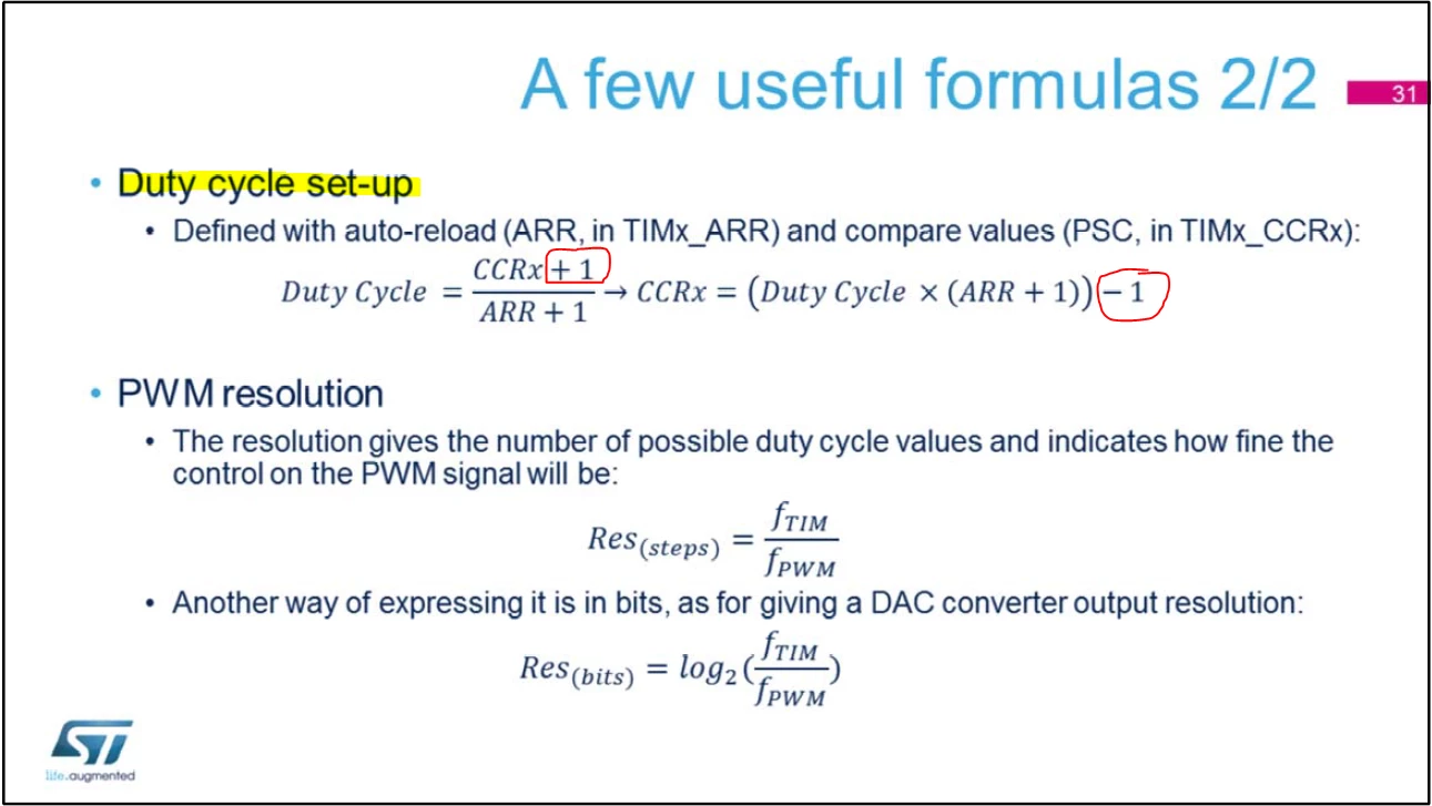

STM32F1xx: Confusion on CCRx value for a given PWM frequency with TIM1 PWM Output???
I'm using an old STM32F103RD with SPL v3.6.1. I'm confused with the value to put in TIM1_CCRx for a giving PWM frequency.
Looking at \STM32Cube_FW_F1_V1.7.0\Projects\STM32F103RB-Nucleo\Examples_LL\TIM\TIM_PWMOutput\Src\main.c:
 /* Set compare value to half of the counter period (50% duty cycle ) */
 LL_TIM_OC_SetCompareCH1(TIM2, ( (LL_TIM_GetAutoReload(TIM2) + 1 ) / 2));
but I found in slider of STM32F7 webinar (en.STM32F7_WDG_TIMERS_GPTIM.pdf, see screenshot) that we should substract 1.
Ex: ARR = 4999, for a duty cyle of 50%, CCR1 = (4999+1) * 0.5 = 2500 or 2499?
Does the PWM mode (edge vs center-aligned) have an impact CCRx formula?
    These are things you should be able to readily check with a scope. Would suggest using smaller numbers so the granularity of the difference is obvious.
    My understanding of the PWM1 mechanics are:
    Where ARR = 4999
    CCR1=0 Always Off
    CCR1=5000 Always On
    CCR1=1250 25%
    CCR1=2500 50%

    JayD
    JayDAuthor
    Jul 10, 2019 4:19 PM UTC
    Thank you for the quick answer Clive!
    That's what I tought also before seeing "useful formula" slide from STM32F7 webinar which confuse me.
    From the reference manual of STM32F10x (see screen capture), there seems to be a slight difference for Always On (100%) between Edge vs Center-Aligned PWM generation.

    waclawek.jan
    Jul 10, 2019 5:36 PM UTC
    The issue here is not edge vs. center aligned, but up vs. downcounting. Downcounting shifts the edge by one count, see description of PWM modes in TIMx_CCMR1.OC1M. Center aligned changes direction soon enough that that shift results in the no pulse for CNT=ARR case, presumable for reasons of symmetry.
    One consequence of what's said above is also that there's no 0% PWM in edge-aligned downcounting.
    JayD
    JayDAuthor
    Jul 10, 2019 9:01 PM UTC
    Clive's answer is confirmed in AN2580 - STM32F10xxx TIM1 application examples.pdf.
    @JW Thank you for the edge vs center aligned clarification.
