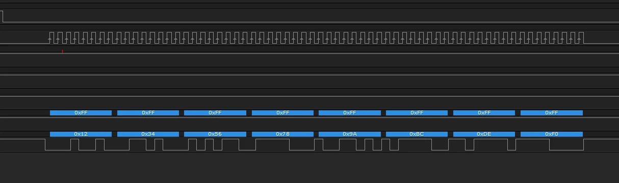

When I try to read in master mode, I must send data for the peripheral to send out a clock so I can read the data.
When I am reading data, I am reading back what I sent.
I have used the SPI in interrupt and with DMA and have the same issue.
When I try to write/read, I read the first byte properly, but then I read back what I placed in the DR register
Using a logic analyzer, I was able to see that my master and slave are transmitting the bytes properly.
From this stream, I would expect to read 0xFF 8 times.
However, my RX buffer will contain: 0xFF 0x12 0x34 0x56 0x78 0x9A 0xBC 0xDE

    I might have phrased my question wrong, but I would like to use the SPI in full duplex mode using the DMA.
    Somehow, the read of the SPI doesn't seem to work, because as I have mentioned, I am reading back what I sent (so it's as if RX and TX buffer are the same). If you look back at the logic analyzer screenshot from my original post, I should be reading 0xFF 8 times, but it's not the case.
