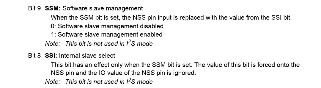

> What could be causing the SPI2 peripheral to not drive NSS high when idle?
F10x have no (automatic working) NSS hardware, you can set it only by (your) software.
Or set SSI on and off, but anyway you have to do it in software.

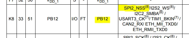

That's not true at all.
From DS6014:
From RM0008:
You're pointing to the SSM and SSI bits, which affect the behavior of NSS in slave mode.  In slave mode, NSS is an input.  I am using the peripheral in master mode, in which NSS is an output.  Furthermore, SSM controls whether the peripheral pays attention to the hardware NSS pin (SSM = 0) or the SSI bit (SSM = 1).
I realize my original post didn't specify master mode.  I've corrected that omission.

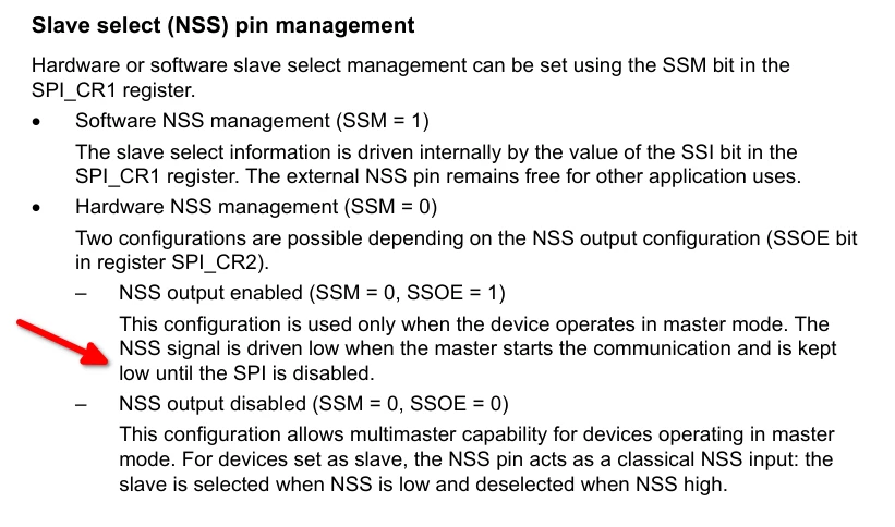

Reading further in RM0008, I see:
I've already encountered some odd behavior in my code where certain callbacks are not being called reliably from the HAL layer.  It could be that the code in the HAL layer that disables SPI after a transaction is also not being called reliably.  I'm not sure why those calls aren't happening but I suspect some kind of timing or interrupt priority issue with my code, because it changes based on whether I have certain breakpoints set.
If I can figure out why the callbacks aren't getting called, maybe that will also solve my NSS problem.
