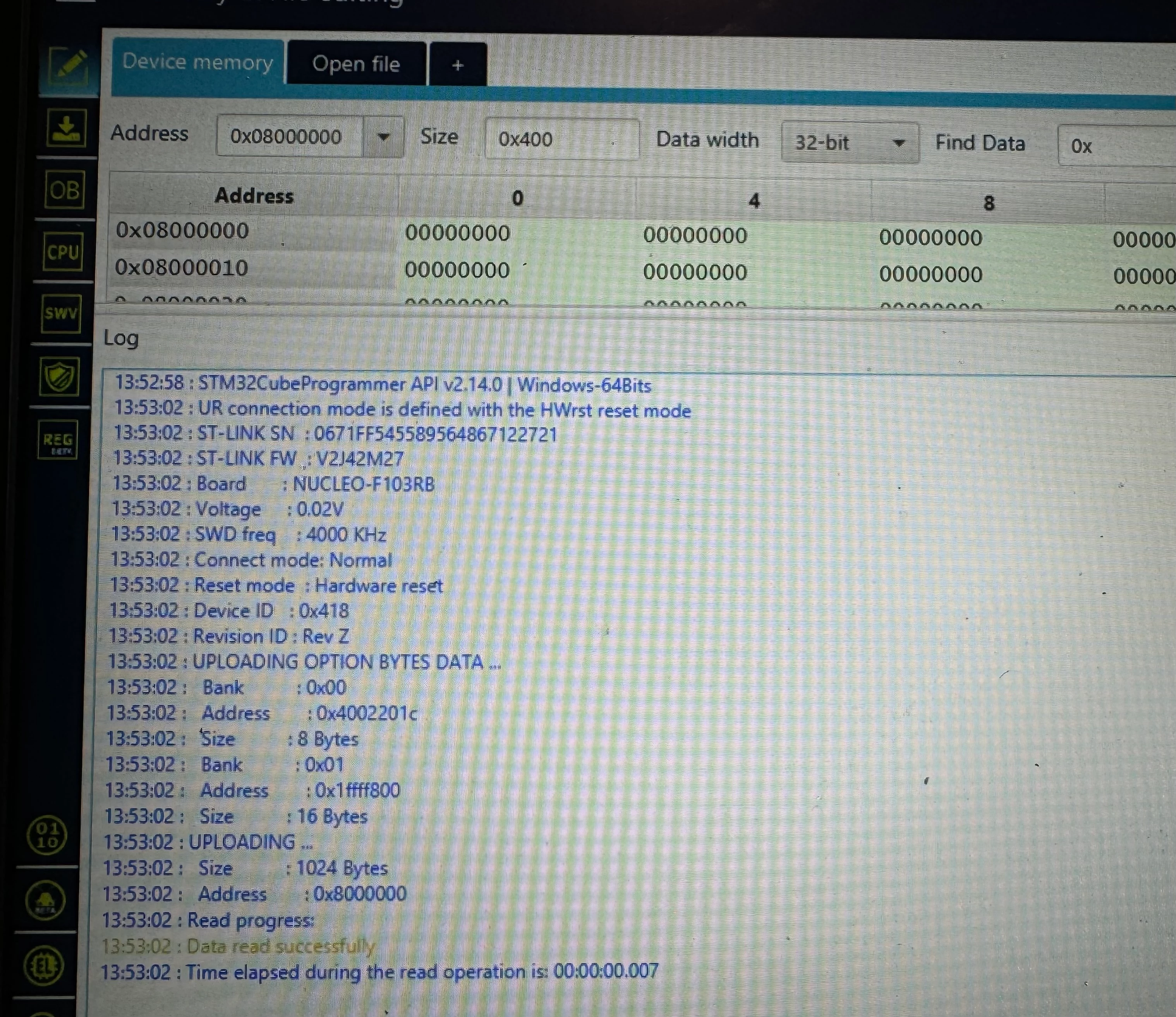

in the process of or at least i want to backup the mcu data and transfer it over to another mcu,  i can connect and see the mcu with my pe cyclone fx but when i read and dump the data i get a empty file 768kb.

That would explain what you're seeing. It would help if you told us what the RDP option byte is set at. Shouldn't have to guess.

Not sure what you're looking for from the presentation here.
Can you do this with an ST-LINK and STM32 Cube Programmer?
Any indication of a connection error, failure or protection in place?

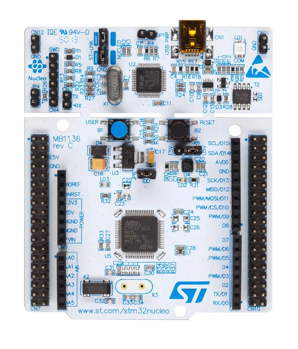

I have a stm32 nucleo-64 stm32f103 and i tried to use the swd port to connect to the target board via pin 1-6 and could not, is this the correct board do i need another one?

For the NUCLEO to connect to an external target you must pull the jumpers to disconnect the local target.

i can see and connect to the mcu see the option bytes and dump the flash file just that's its empty and has no data, could it be locked in a away it allows connection in debug mode but not dump the files?

I'd expect to see data at 0x08000000 if present.
I would expect to see some errors if RDP was enabled.
Being all zeros is odd, does the part work properly otherwise?
Could it have blanked itself? ie aggressive protection mechanism.
Can you get an image from the vendor?

what pins do i remove to make it read external target?
September 7, 2024
Disconnect both jumpers on CN2. Connect GND/SWDIO/SWCLK between CN4 and your target board. Ensure target board has power. Optionally, also connect VCC and NRST. See nucleo user manual for CN4 pinout.
  • Pin 1: Target VCC
  • Pin 2: SWCLK
  • Pin 3: GND
  • Pin 4: SWDIO
  • Pin 5: NRST
  • Pin 6: SWO
After that connect with STM32CubeProgrammer and observe flash data.

so i have both options to power the mcu via the st-link completely via pins 1-6 or externally using the pins for data
September 7, 2024
You cannot power the board with pin 1 of CN4. It is an input to the st-link.
You must power the board some other way.

Voltage: 0.01 V suggests it isn't powered, or that you don't have power hooked up. It looks hooked up in your pictures.
Is RDP set? Check option bytes in OB tab on left.

I went ahead and activated the RDP on this teta board just to see and am getting the same message from the other one so am to assume I just locked the test board , how do I unlock it again ??
September 7, 2024
Go to option bytes and change RDP to level 0.
