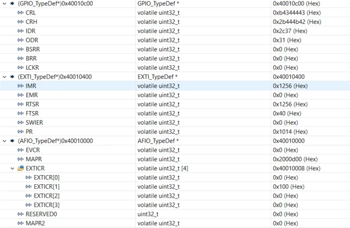

STM32F105RC PB6 always stay 0, EXTI never trigg

// PB6 Main sync pin
GPIO_InitTypeDef GPIO_InitStructure;
GPIO_InitStructure.GPIO_Pin = GPIO_Pin_6;
GPIO_InitStructure.GPIO_Mode = GPIO_Mode_IN_FLOATING;
GPIO_InitStructure.GPIO_Speed = GPIO_Speed_2MHz;
GPIO_Init(GPIOB, &GPIO_InitStructure);
// Connect EXTI6 Line to PB6 pin
GPIO_EXTILineConfig(GPIO_PortSourceGPIOB, GPIO_PinSource6);
//Configure EXTI 6
EXTI_InitTypeDef EXTI_InitStructure;
EXTI_InitStructure.EXTI_Line = EXTI_Line6;
EXTI_InitStructure.EXTI_Mode = EXTI_Mode_Interrupt;
EXTI_InitStructure.EXTI_Trigger = EXTI_Trigger_Rising_Falling;
EXTI_InitStructure.EXTI_LineCmd = ENABLE;
EXTI_Init(&EXTI_InitStructure);
/* Enable the EXTI9_5 Interrupt */
NVIC_InitTypeDef NVIC_InitStructure;
NVIC_InitStructure.NVIC_IRQChannel = EXTI9_5_IRQn;
NVIC_InitStructure.NVIC_IRQChannelPreemptionPriority = 0;
NVIC_InitStructure.NVIC_IRQChannelSubPriority = 0;
NVIC_InitStructure.NVIC_IRQChannelCmd = ENABLE;
NVIC_Init(&NVIC_InitStructure);
NVIC_EnableIRQ(EXTI9_5_IRQn);
/* Clear interrupt flag */
EXTI_ClearITPendingBit(EXTI_Line6);Hi, I've got a problem with my EXTI6. I try to get interrupt on falling and rising edges.
I've watched SFR register but I don't understand why it doesn't work.
PB IDR bit 6 always stay to 0 but I'm sure it's not true.
IRQ are enabled, software interrupt trig works perfectly.
I use Eclipse with Std peripheral lib V3.5.0.
Is anyone think about something ?
EDIT : Signal NOT moving when my program running.
Thanks.
