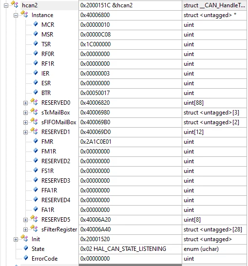

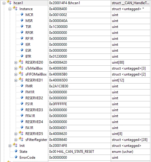

Maybe important, after the initalization I'm starting the CAN2 Modul with:
HAL_CAN_Start(&hcan2);
and some pictures of the CAN Registers:
