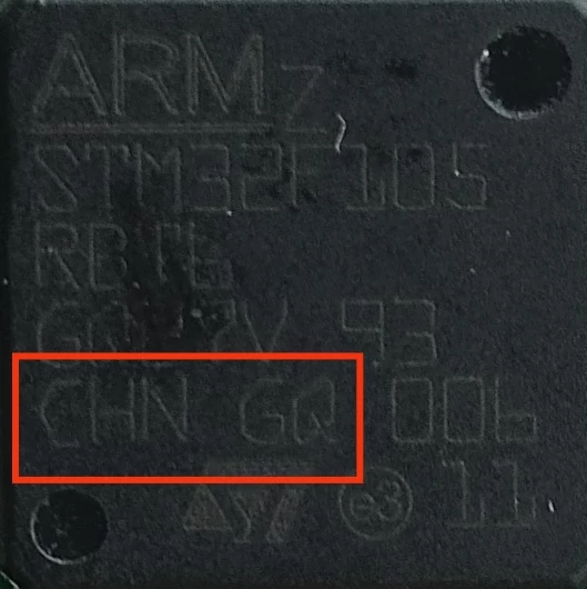

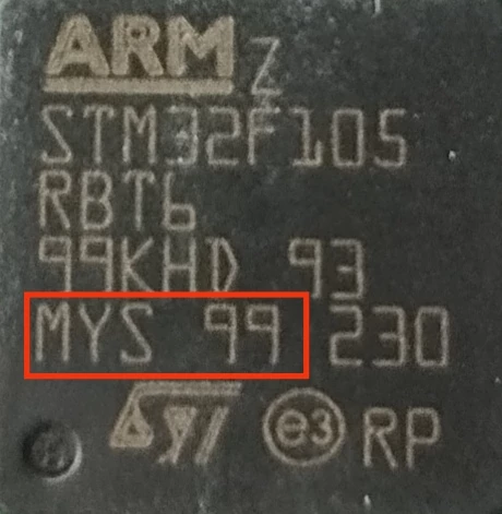

I read out bin file from MCU STM32F105 and tried to write to the same new MCU, but on new MCU firmware do not work correctly.
Different is between those mcu the old have marked CHN GQ and new one have MYS 99
Any ideas where is the problem?

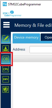

It could be something related to the option bytes.

Did you retrieve the all Flash content?
As it could be something related to the option bytes (different values). You can check and compare the content of the option bytes using STM32CubeProgrammer tool going to OB menu:

Old chip is damaged, one pin is broken I have resoldered new chip to old pcb, so problem can be only with new chip or firmware.
