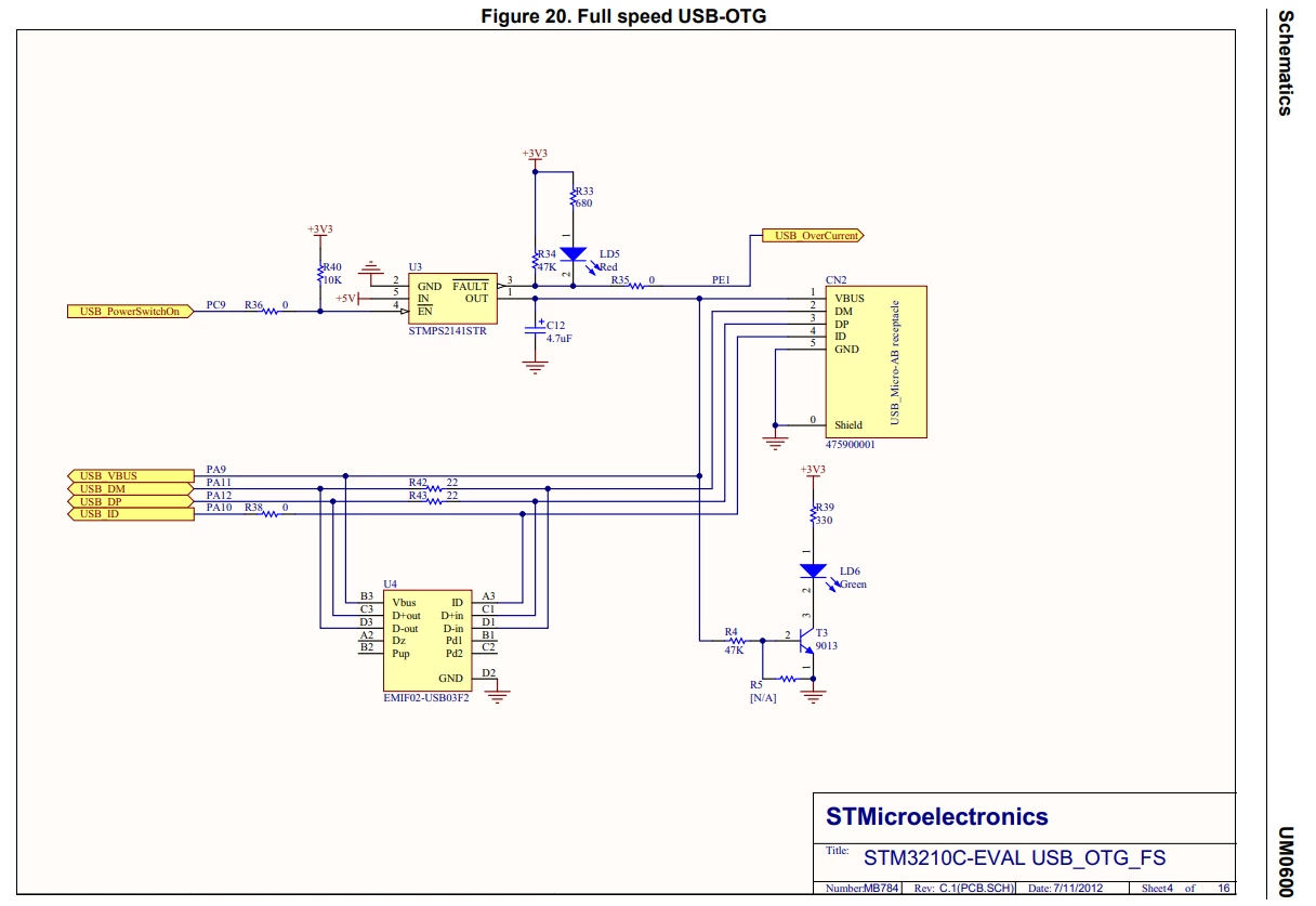

Hi all.
I'm new to STM, but have been designing and making embedded MCU products for over ten years.
I was drawn to the STM32F105 series because of the USB DFU, to allow for field updates for prospective customers to update a product we're developing. Outside of USB DFU functionality, we just need 3x UART's, one GPI, one GPO. That's it. We steer clear of USART1 because of it's overlap with OTG_FS pins. We have got our product working using a ST-Link programmer, but not as yet using the USB DFU.
Our USB connection just isn't enumerating. The wiring is correct when compared to off-the-shelf STM32 enabled boards with OTG USB interfaces.
I am across the date code bootloader issue as described in AN2606, our chips definitely come with bootloader 2.2. I have VBUS from the USB-C tied to PA9 (OTG_FS_VBUS). Yes, USB-C but with the 5.1K resistors between CC1, CC2 and GND. NRST is pulled to 3V3 with a 10K pull-up. Boot0 and Boot1 is pulled to GND via a 10K pull-down, Boot0 also runs to a tactile NO pushbutton that throws to 3V3. Holding the button down while applying power does successfully put the micro into bootloader mode (tested with J-Link), so the pattern is correct.
I have an external 8MHz crystal. I read somewhere that folks specifically had no luck with this and had to use 25MHz to get USB DFU. Is that correct? I assume the IOC in STM32CubeIDE is only relevant for my program and not for the stock bootloader? (Re Clock Configuration, Connectivity>USB_OTG_FS in particular)? When I put our code into a program I configured in STM32CubeIDE for the STM32F405 (Adafruit Feather STM32F405 Express) and uploaded it, the clock configuration and USB_OTG_FS settings didn't make any difference to how the board behaved in bootloader mode, its USB DFU worked fine.
Do I need any other pins connected? OTG_FS_ID? OTG_FS_SOF?
Many thanks in advance!

jiangfan
Apr 17, 2025 3:15 AM UTC
about STM32F105 USB/DFU, you may refer to official ST board schematics, STM3210C-EVAL/MB784. Unfortunately this board is OBSOLETE. Anyway, it may be found, so, you can refer to following schematics
jiangfan
Apr 17, 2025 3:18 AM UTC
about "I have an external 8MHz crystal. I read somewhere that folks specifically had no luck with this and had to use 25MHz to get USB DFU. Is that correct? "
I don't think so. 25MHz is mainly for ethernet. 8MHz crystal should be OK if you don't use ethernet - you use USB/OTG only.

Hi @Tad_E
I would add that STM32F105 is embedding internally pull up on DP. So, no need to add an external one.
Additional pins (OTG_FS_ID, OTG_FS_SOF) are not required to be connected for USB DFU to work.
  1. OTG_FS_ID pin is meant for changing data roles dynamically (host to device and reversly).
  2. _SOF pin is essentially used in host mode to synchronize with devices especially for isochronous transfers.
About clock configuration settings, it could be an issue in dividers combination proposed by CubeMX clock tree. First, ensure that bootloader mode is correctly entered by checking with a tool like STM32CubeProgrammer.
