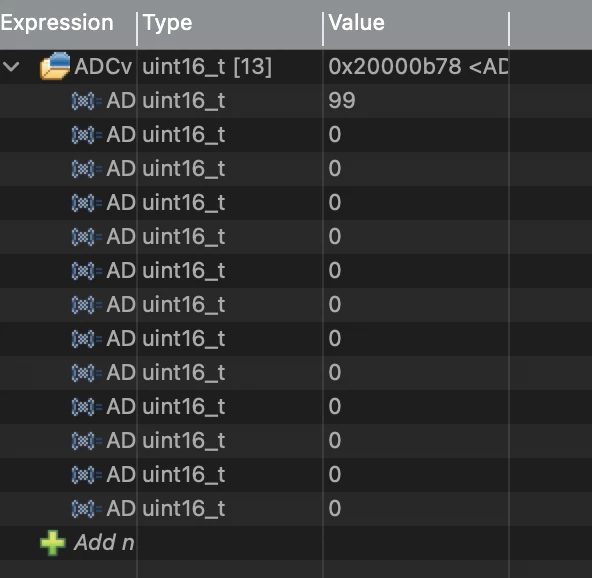

The problem is I only get the first reading and the rest of the buffer stays empty.

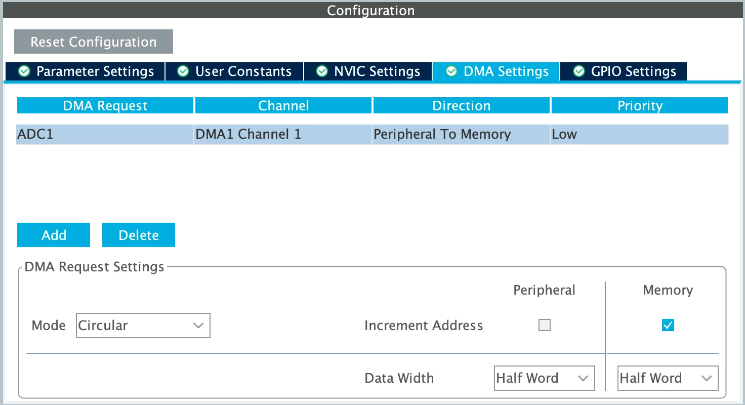

It seems the pointer to the buffer array is not correct or the DMA is not incrementing to the next index.

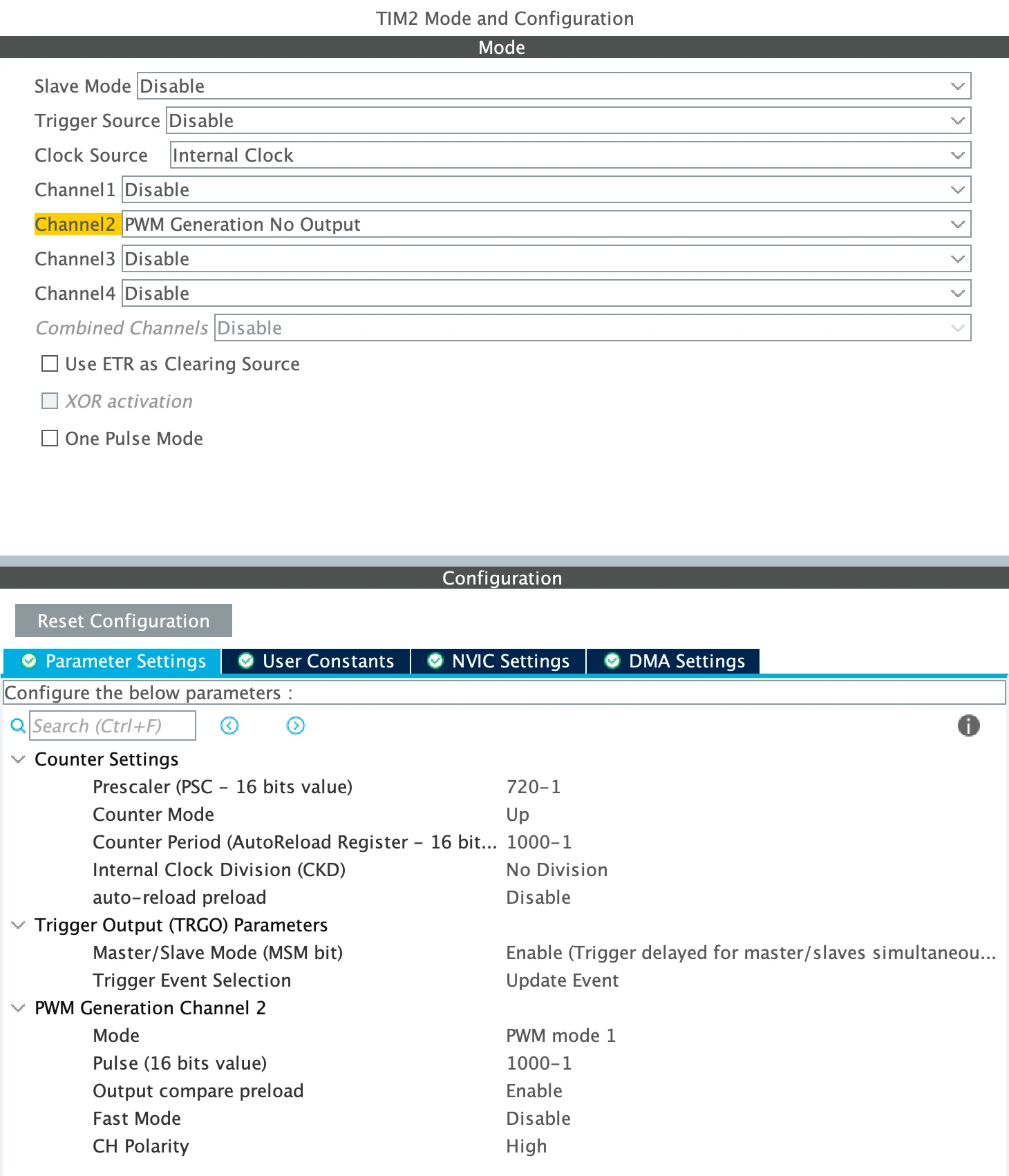

In the main I start ADC with DMA and the timer 2 channel 2 PWM

	if (HAL_ADC_Start_DMA(&hadc1, (uint32_t*)&ADCvalue, ADC_BUFFER_SIZE) != HAL_OK) {

	// Start timer 2 CC2 trigger for ADC1
	if (HAL_TIM_PWM_Start(&htim2, TIM_CHANNEL_2) != HAL_OK) {
		Error_Handler();

The conversion seems to start and I get the HAL_ADC_ConvCpltCallback.

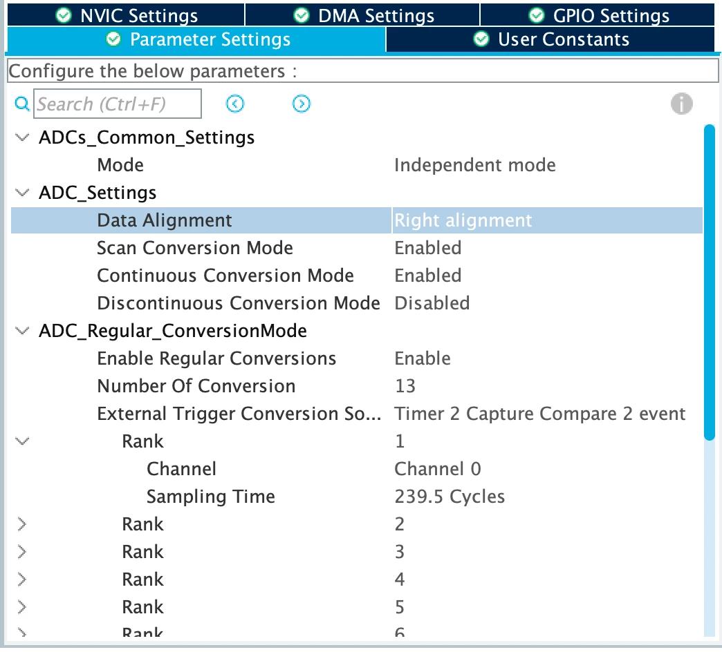

Bellow the CubeIDE settings and the automatically created code.

 /** Common config
 hadc1.Instance = ADC1;
 hadc1.Init.ScanConvMode = ADC_SCAN_ENABLE;
 hadc1.Init.ContinuousConvMode = ENABLE;
 hadc1.Init.DiscontinuousConvMode = DISABLE;
 hadc1.Init.ExternalTrigConv = ADC_EXTERNALTRIGCONV_T2_CC2;
 hadc1.Init.DataAlign = ADC_DATAALIGN_RIGHT;
 hadc1.Init.NbrOfConversion = 13;
 if (HAL_ADC_Init(&hadc1) != HAL_OK)

What is your O/P ADCvalue? Can you share the picture of that
Make sure your ADC is getting triggered after the timer counter overflow.

What do you mean with O/P ADC value? Reference voltage?

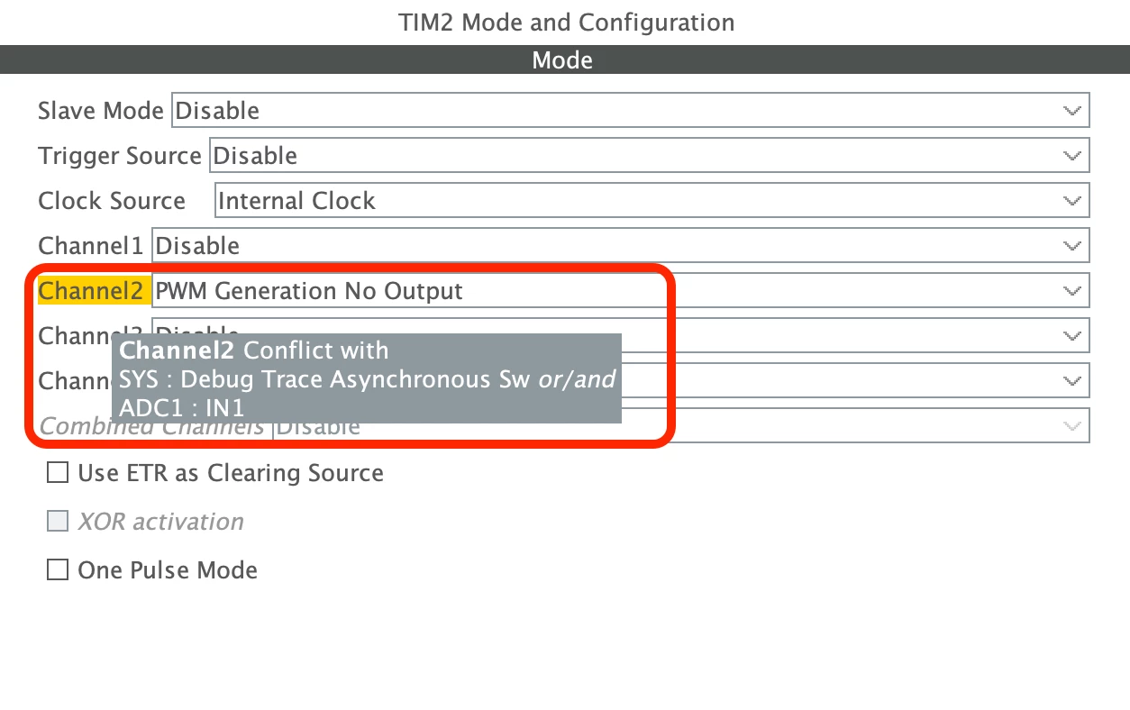

As I understand the ADC gets triggered when the CC (Capture Compare) value matches the timer counter. Which works.
I tried timer 3 out event as trigger source because I get this conflict warning for Timer 2 channel 2.0693W00000QNafFQAT.pngBut no difference. The conversion starts and I get the call back but only first value in the buffer.
