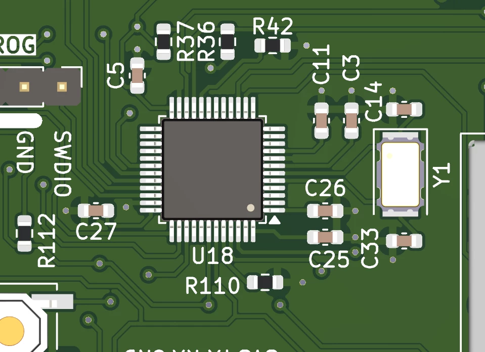

I've a board with the STM32F103C8T6 MCU.

2) Is there any other candidate in a small package (like the LQFP-48) I can use? I have to use a small package cause I don't have that much space available on that board (find attached)

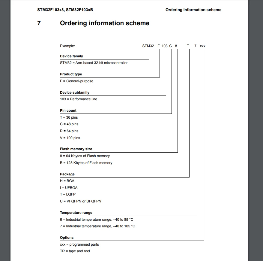

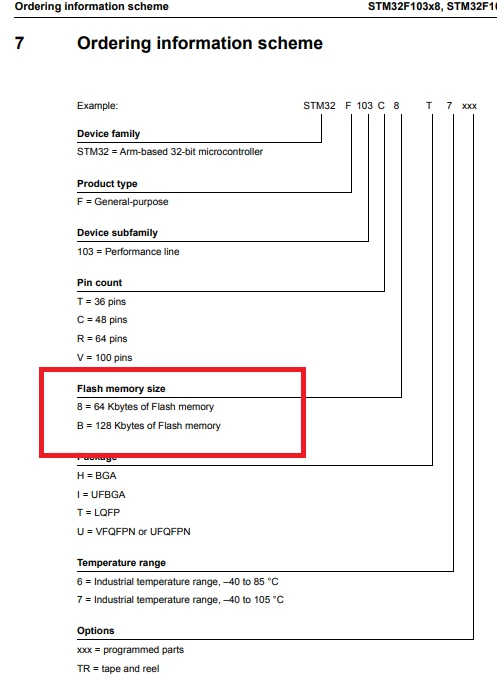

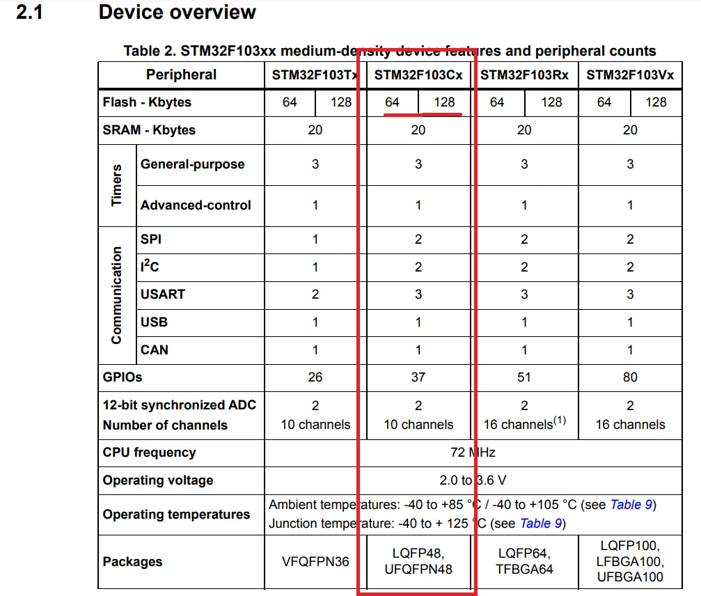

The answer is provided in the datasheet:
The only difference is the Flash size so you don't have to worry.
lk.dgironi
November 4, 2024
Thanks, so it's a yes on my request "1)", no issues replacing with STM32F103CBT6.
