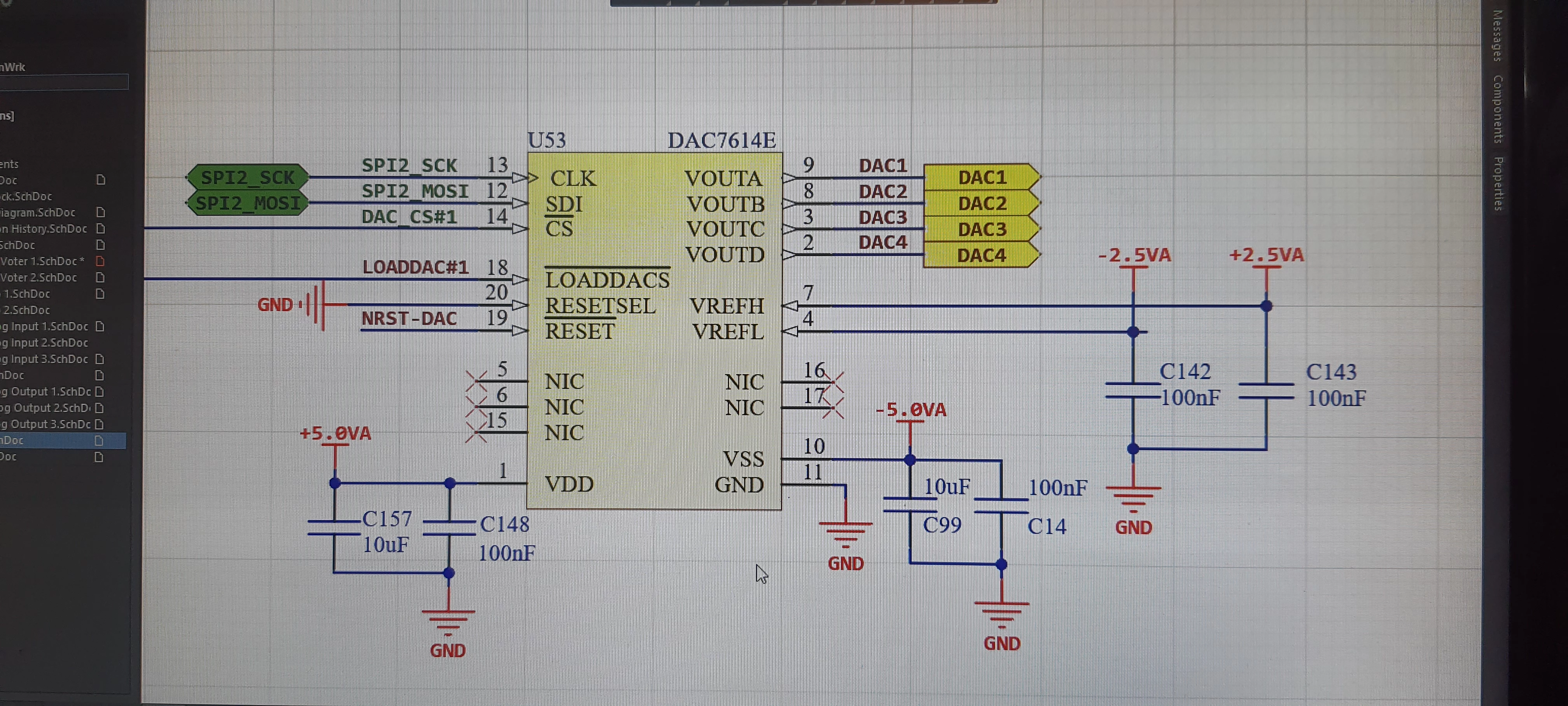

This is supposed to be simple, but I have a serious problem that left me no choice but ask for a help! So any contribution is appreciated =)

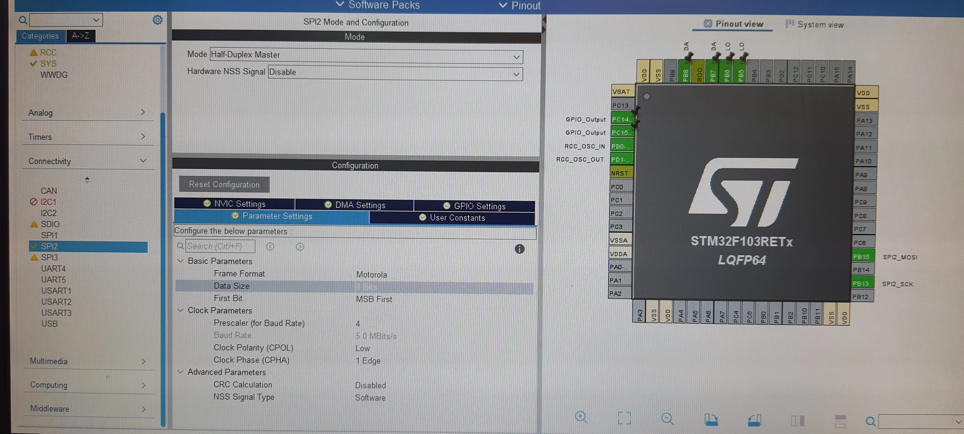

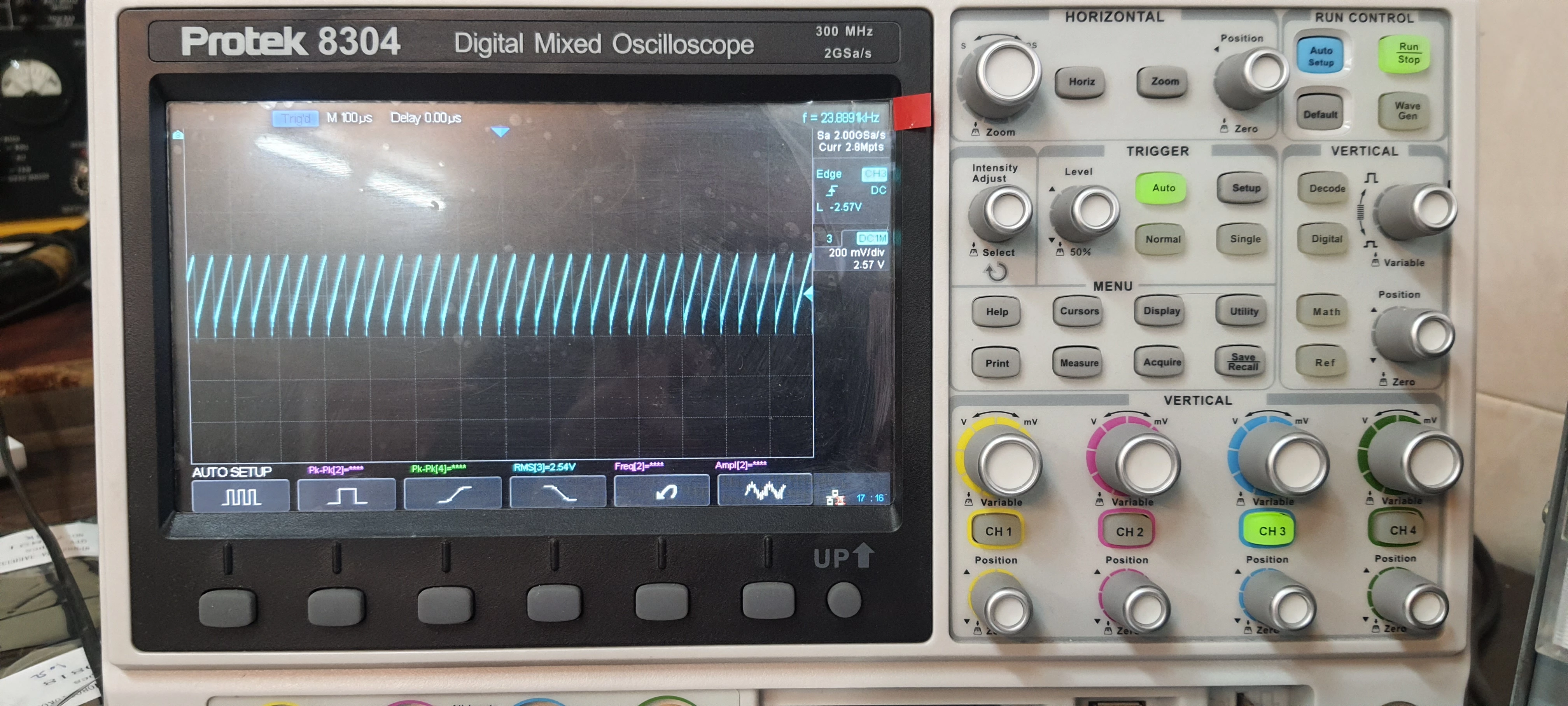

I have interfaced a STM32F103RET6 with an external 7614e DAC using SPI. According to the DAC datasheet I have set the values and it seemed easy. I am trying to make analoge signal in the outpout​, but what I get is just triangle wave and I don't know why!
I would be thankful if you help me with this matter.​
I think the problem is in my code or configuration of SPI in Cubemx!​ briefly: I used a spi interrupt to tell me when the transmission is done to set or reset CS or LOADDAC pins in DAC.
PIN B7: refers to DAC CS
PIN B5: refers to DAV LOADDAC
Here is my code:
