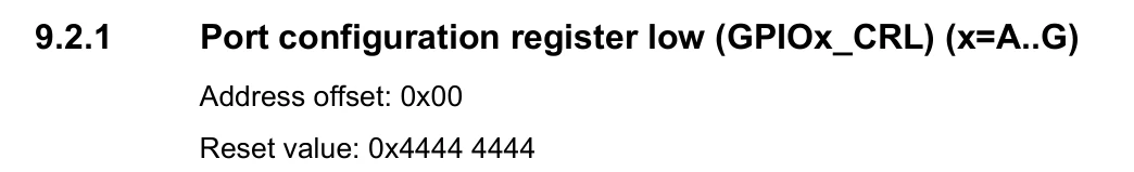

I got the boards built, and I'm starting testing.  SPI3 is not functional, so I started stepping through and checking SFRs.  One problem I'm having is that PB3 (SCK) and PB5 (MOSI) refuse to configure as alternate function push pull.
In lines 26-33 below, PA15 goes to output, alternate function push pull just fine.  But PB3 and PB5 will only go to output, and open drain.  In line 35, I even tried to force the mode bits to "10" (alternate function push pull), and when I observe the mode bits for PA3 and PA5, they get set to "11" (alternate function output open drain).  My current attempt at SPI3 initialization is:

The default value of the CRL and CRH registers is not 0. You're only setting bits--you need to reset bits that are already set as well.

You are correct sir!  I changed that to:
 GPIOB->CRL |= 0x00909000;	//***Force MODE and CNF bits manually
 GPIOB->CRL &= ~0x00404000;
And the SPI module is alive and transmitting now.  However, the chip select on PA15 is still not responding.
