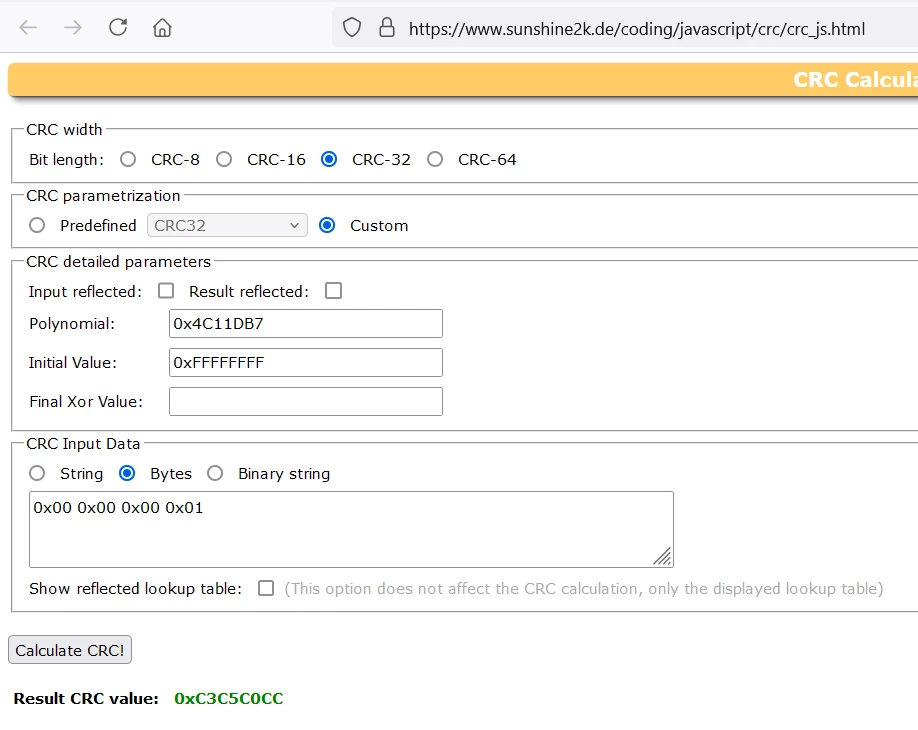

stm32f103re CRC ?
hi
i used of CRC in stm32CubeMX and for check true worked CRC used of two online CRC calculator site:
https://www.sunshine2k.de/coding/javascript/crc/crc_js.html
https://crccalc.com/?crc=123456789&method=&datatype=0&outtype=0
i think stm32cubeIDE internal CRC use of standard CRC32_MPEG2:
Polynomial = 0x4C11DB7
Initial value = 0xFFFFFFFF
Final XoR Value = 0x0
Input reflected = disable
Result reflected = disable
Am I correct and have I written the CRC parameter values ​​for stm32f103 exactly right?
but CRC result for stm32CubeIDE different with online CRC calculator site?
example:
stm32 CRC for 0x00 = 0xc704dd7b
online CRC calculator site for 0x00 = 0x4E08BFB4
stm32 CRC for 0x01 = 0xc3c5c0cc
online CRC calculator site for 0x01 = 0x4AC9A203
stm32 CRC for 0x02 = 0xce86e615
online CRC calculator site for 0x02 = 0x478A84DA
stm32 CRC for 0xFF = 0x76f39dcf
online CRC calculator site for 0xFF = 0xFFFFFF00

    waclawek.jan
    waclawek.janBest answer
    October 4, 2024
    The CRC unit in 'F1 calculates CRC only from 32-bit words, so for example for your 0x01 input it uses 0x00000001 (big endian, so 0x00 0x00 0x00 0x01):
    6 replies

    waclawek.jan
    October 4, 2024
    kshin.111
    kshin.111Author
    October 4, 2024
    thanks thanks thanks
