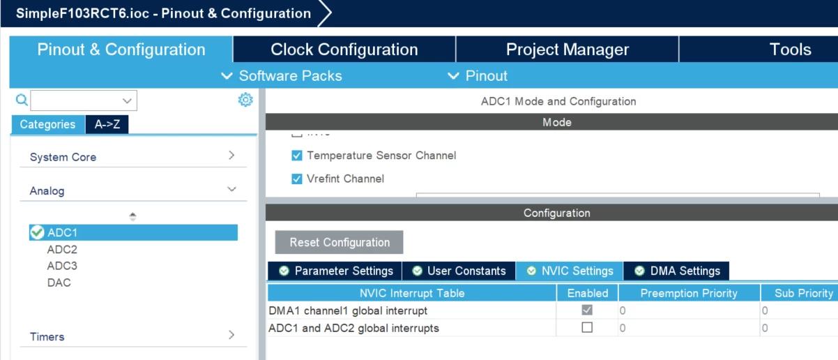

STM32F103RC Wrong ADC Readings on Vrefint and TempSensor Channels
The ADC test has only 2 channels: Vrefint and TempSensor. The following ADC result (convertedData) is read out through DMA:
tick = 1s - convertedData[0] = 113968573 convertedData[1] = 0
tick = 2s - convertedData[0] = 113837503 convertedData[1] = 0
tick = 3s - convertedData[0] = 96339657 convertedData[1] = 0
tick = 4s - convertedData[0] = 113837502 convertedData[1] = 0
tick = 5s - convertedData[0] = 113837503 convertedData[1] = 0
tick = 6s - convertedData[0] = 96405193 convertedData[1] = 0
tick = 7s - convertedData[0] = 113837503 convertedData[1] = 0
tick = 8s - convertedData[0] = 113837502 convertedData[1] = 0
tick = 9s - convertedData[0] = 96405192 convertedData[1] = 0
 Where convertedData[0] is the ADC reading of Vrefint which should be 4095, the other is that of TempSensor which should not be 0.

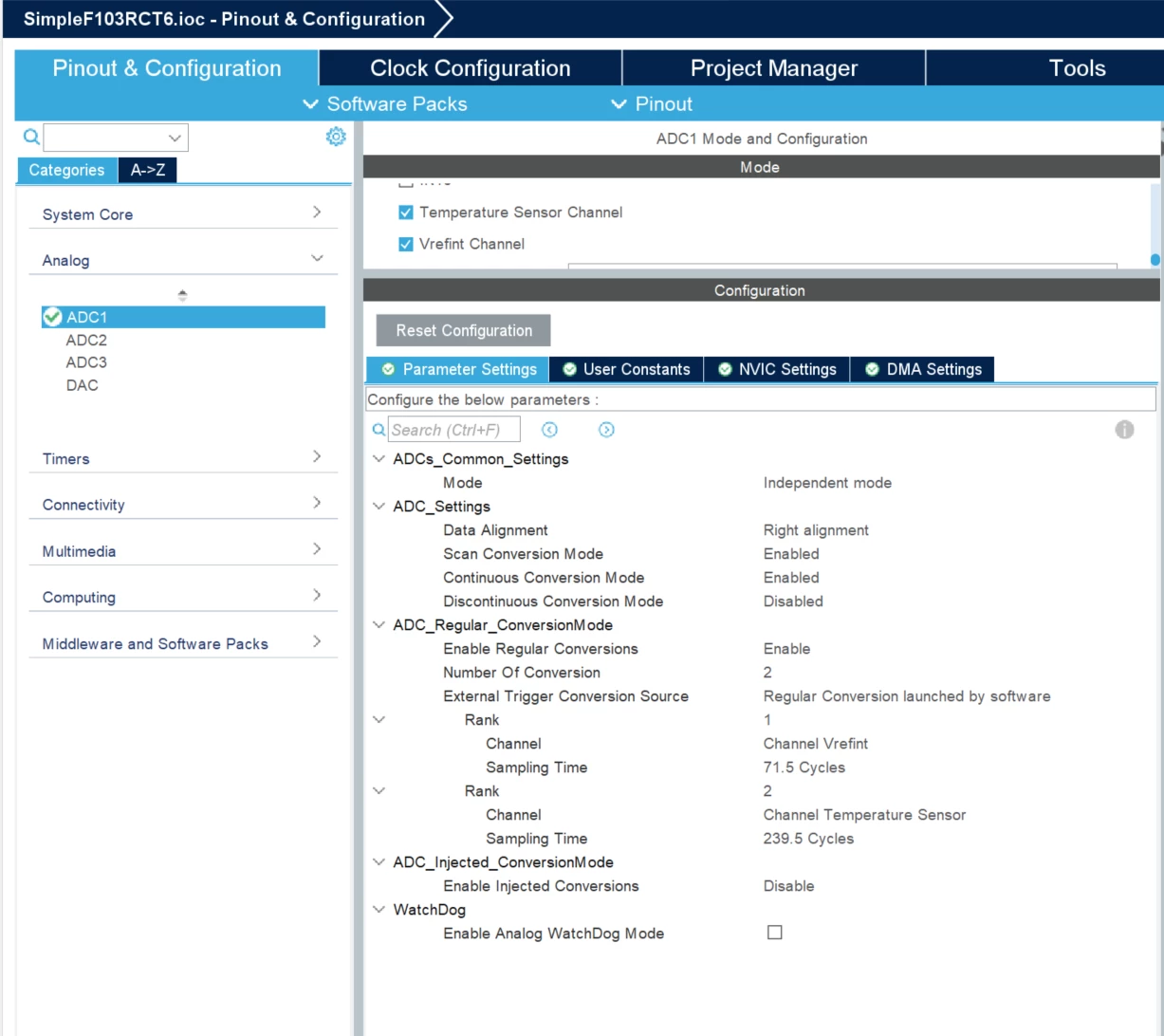

The ADC configuration:
The code:

static void MX_ADC1_Init(void)
 ADC_ChannelConfTypeDef sConfig = {0};
 /** Common config
 hadc1.Instance = ADC1;
 hadc1.Init.ScanConvMode = ADC_SCAN_ENABLE;
 hadc1.Init.ContinuousConvMode = ENABLE;
 hadc1.Init.DiscontinuousConvMode = DISABLE;
 hadc1.Init.ExternalTrigConv = ADC_SOFTWARE_START;
 hadc1.Init.DataAlign = ADC_DATAALIGN_RIGHT;
 hadc1.Init.NbrOfConversion = 2;
 if (HAL_ADC_Init(&hadc1) != HAL_OK)
 Error_Handler();
 /** Configure Regular Channel
 sConfig.Channel = ADC_CHANNEL_VREFINT;
 sConfig.Rank = ADC_REGULAR_RANK_1;
 sConfig.SamplingTime = ADC_SAMPLETIME_71CYCLES_5;
 if (HAL_ADC_ConfigChannel(&hadc1, &sConfig) != HAL_OK)
 Error_Handler();
 sConfig.Channel = ADC_CHANNEL_TEMPSENSOR;
 sConfig.Rank = ADC_REGULAR_RANK_2;
 sConfig.SamplingTime = ADC_SAMPLETIME_239CYCLES_5;
 Error_Handler();

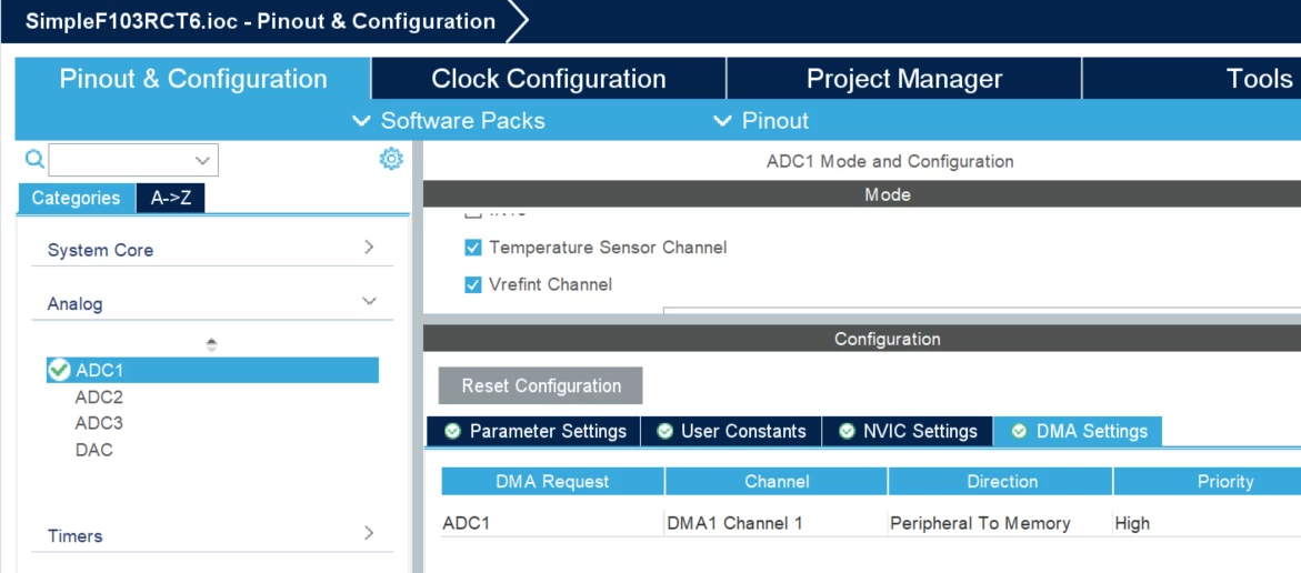

static void MX_DMA_Init(void)
 /* DMA controller clock enable */
 __HAL_RCC_DMA1_CLK_ENABLE();
 /* DMA interrupt init */
 /* DMA1_Channel1_IRQn interrupt configuration */
 HAL_NVIC_SetPriority(DMA1_Channel1_IRQn, 0, 0);
 HAL_NVIC_EnableIRQ(DMA1_Channel1_IRQn);

TDKBest answer
Mar 16, 2024 3:48 PM UTC
You have likely defined convertedData as a uint32_t array instead of a uint16_t array.

ChaoAuthor
Senior
Mar 16, 2024 5:37 PM UTC
Thanks. You are right.
After having changed to uint16_t, the readings are still wrong:
tick = 1s - convertedData[0] = 1470 convertedData[1] = 1742 Vrefint = 1184 Tmcu = 31
tick = 2s - convertedData[0] = 1470 convertedData[1] = 1741 Vrefint = 1184 Tmcu = 31
tick = 3s - convertedData[0] = 1470 convertedData[1] = 1740 Vrefint = 1184 Tmcu = 31
tick = 4s - convertedData[0] = 1740 convertedData[1] = 1470 Vrefint = 1184 Tmcu = 31
tick = 5s - convertedData[0] = 1470 convertedData[1] = 1740 Vrefint = 1184 Tmcu = 31
tick = 6s - convertedData[0] = 1471 convertedData[1] = 1741 Vrefint = 1185 Tmcu = 31
tick = 7s - convertedData[0] = 1740 convertedData[1] = 1470 Vrefint = 1185 Tmcu = 31
tick = 8s - convertedData[0] = 1471 convertedData[1] = 1740 Vrefint = 1185 Tmcu = 31
tick = 9s - convertedData[0] = 1470 convertedData[1] = 1740 Vrefint = 1184 Tmcu = 31
tick = 10s - convertedData[0] = 1740 convertedData[1] = 1470 Vrefint = 1184 Tmcu = 31
And the data pattern looks like the readings of the two channels are mixed up.
Not like with G070, F103 does not have configuration options on sequence conversion.
What I expect for the ADC behaviour is:
1. it completes a conversion every second
2. for each conversion, it converts the both channel one after another
3. the DMA transfers the conversion result into convertedData once a second
I am not sure whether or not it does what I expect.

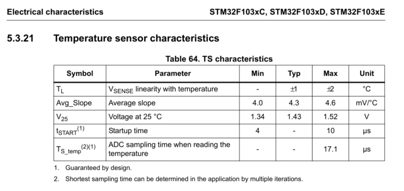

The room temperature is around 21 degree centigrade while the reading is 31.
The temperature sensor characteristics:
Mar 16, 2024 6:18 PM UTC
You have continuous conversions on, so the ADC is constantly running. For what you are doing, this seems like the right thing to do. Just set it to convert those 2 channels forever, and put them in a circular buffer. Read them out whichever you want. Only call HAL_ADC_Start_DMA once at the start.
