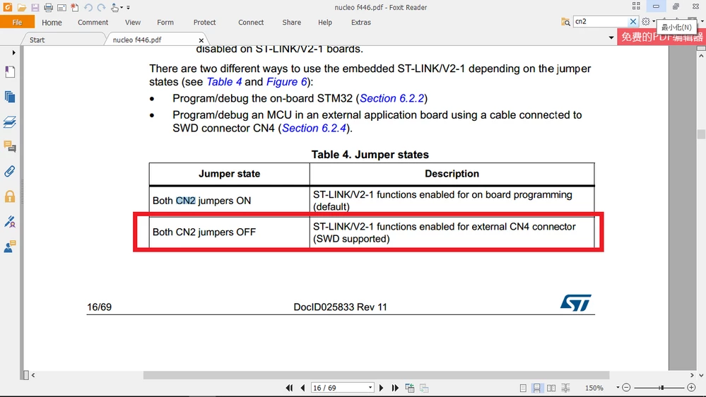

Did you take off jumpers in  CN2?
Also try to use st-link utility first, make sure you can connect to target.

Then I removed the two jumpers on CN2 on Nucleo 64 board. Tried connecting to the ST Link Utility my custom board, but it's showing No target connected.

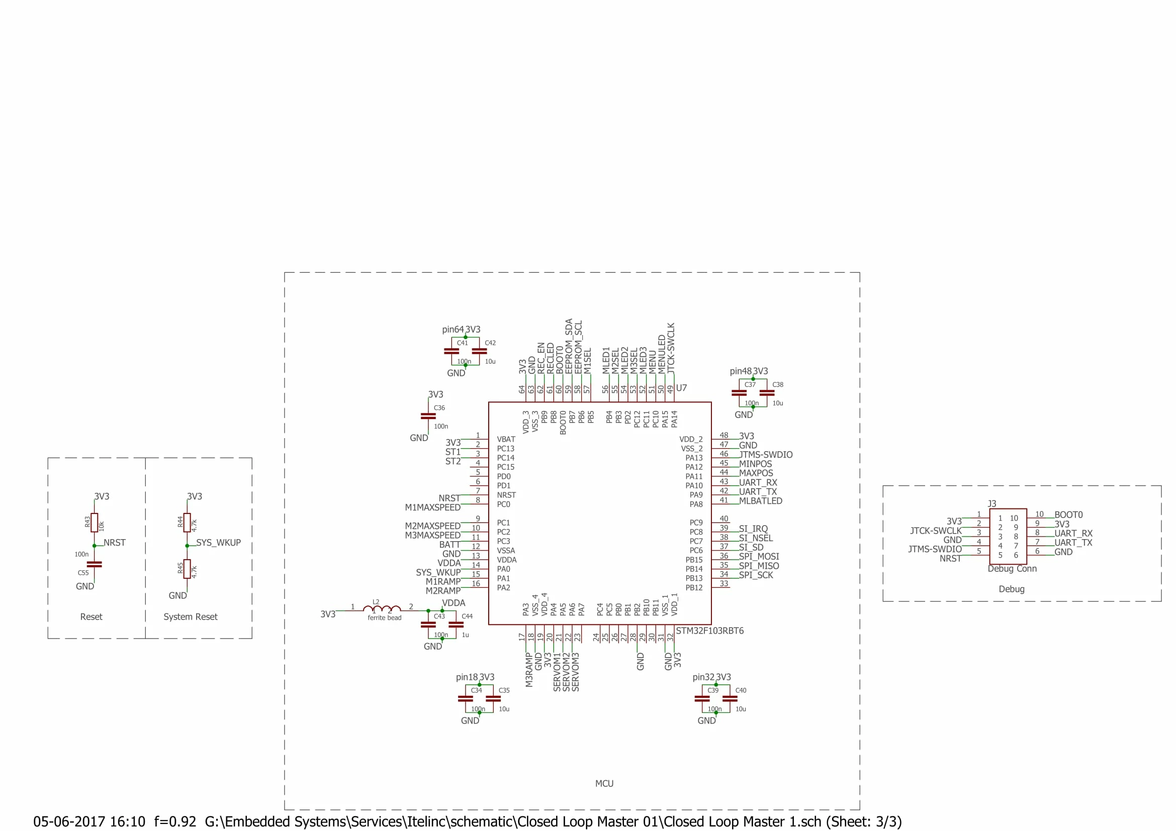

I've attached the MCU design of my custom board. Please review it.
Also I've connected VDD, GND, SW_CLK, SW_DIO, nRST pins from custom board to Nucleo 64 board. Are there any additional pins connections required. 0690X00000603rlQAA.jpg

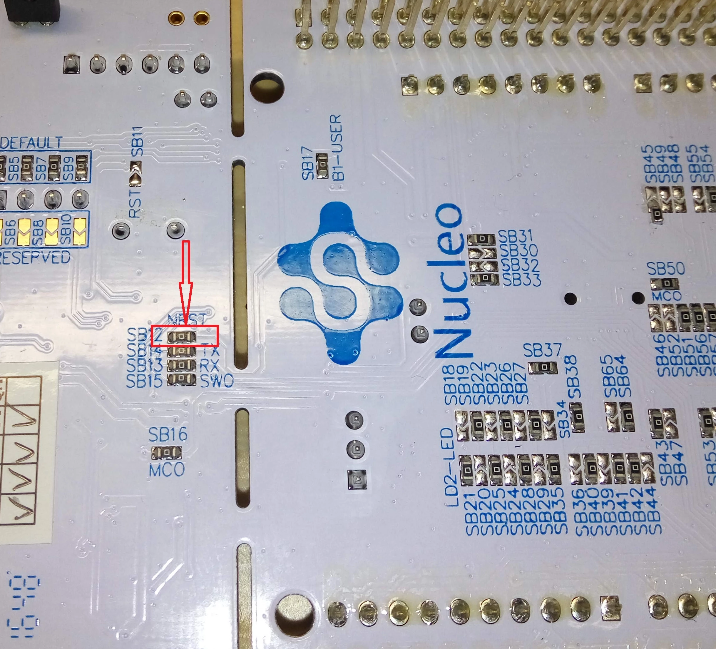

Hey, I think it's the reset pin.
Check your reset pin, if it's held in low state.
If you didn't break out the st-link board, you should do the folllowing modification.
SB12 NRST (target MCU RESET) must be OFF if CN4 pin 5 is used in the external  application. (UM1724 p17)
I remembered before, when using Nucleo 64 board, i use the on board st-link to debug some other custom board, and I didn't break out the st link part from the main board.
I took off the jumper JP6(turning off IDD), thinking it would be better to turn off the MCU belowed. However, without taking off the SB12, it results the reset pin held in low state.
So, did you take off SB12?
Good Luck!

0 use digital meter to check connections of debug pins from st-link to target mcu
1 check whether the reset pin is high. boot0 is ground
2 power on the device and check 3.3V pins
3 make sure your target mcu is not in sotp/sleep/stnadby mode.

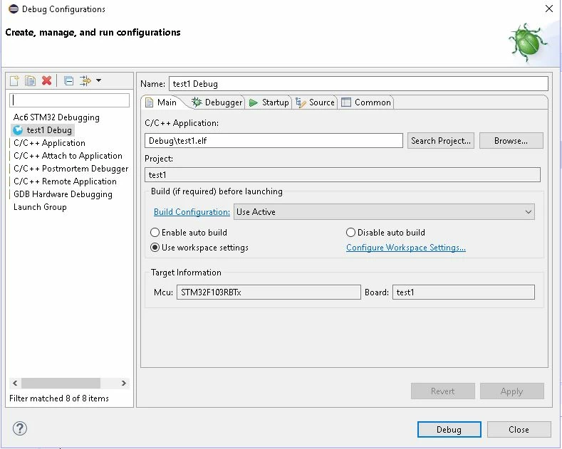

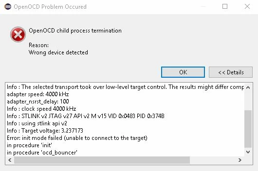

  • On Atolic studio I'm getting the same result: Reason: (-4) No device found on target
  • I tried to debug with System Workbench for STM32. I've attached of debug result.
  • I've also attached the debugger configuration.

Please find the images here
: 0690X00000603s5QAA.jpg
