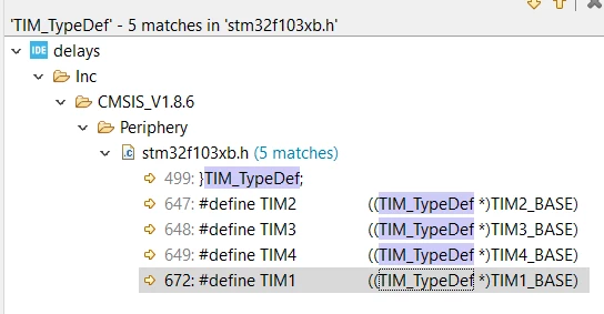

Why do TIM6 and TIM7 timers and its registers not define in CMSIS in stm32f103xb.h file (see Figure 1 below)?
Figure 1
Therefore, it is impossible to use this TIM6->ARR = 0x0001; instruction and similar to this instruction with registers of TIM6 and TIM7 timers.

Well, TIM6 and TIM7 are not defined because they are simply not present in the STM32F103xB. Only the High Densitity (F103xC/D/E) and XL Density (F103xF/G) devices contain TIM6 and TIM7.

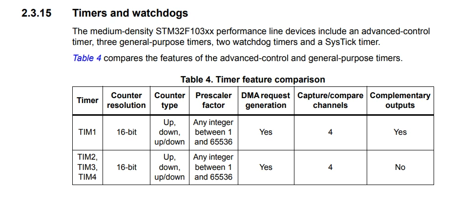

August 28, 2024
Yes,
I see this in the datasheet of STM32F103x8, STM32F103xB microcontrollers in the Table 4 (see Figure 2 below).
Table 4 also shows that STM32F103xx have TIM1, 2, 3 and 4. TIM3 and TIM4 not included in RM0008 Reference manual. Why?

Hello @Mykola_Levun
the RM0008 is the reference manual for STM32F101xx, STM32F102xx, STM32F103xx, STM32F105xx and
STM32F107xx.  So, it describes all interfaces and APIs available on all those series. For the Specification of each model, you need to check the Datasheet. It gives info and details about a Few MCUs. So the details should be there.
