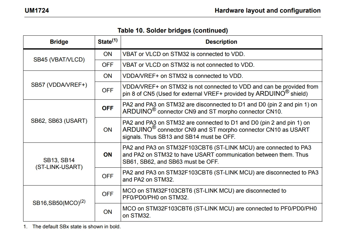

November 5, 2024
What Hardware are you using? ST board? custom board? Blue/Black pill?
November 5, 2024
Yeah,Thank you for the reminder! I’ve checked the UM1724 reference manual and have removed the SB45 solder bridge as suggested for enabling the coin cell backup.
