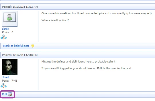

    darekfilip
    January 10, 2014
    Posted on January 10, 2014 at 11:32
    One more information: first time i connected pins rx tx incorrectly (pins were swaped).
    Where is edit option?
    Tesla DeLorean
    Guru
    January 10, 2014
    Posted on January 10, 2014 at 12:18
    Missing the defines and definitions here... probably salient
    If you are still logged in you should see an Edit button under the post.
