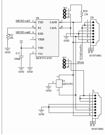

    daniel239955_stm1
    April 24, 2015
    Posted on April 24, 2015 at 10:31
    thanks for reply, but I have 3 nodes connected on bus ,using attachment datasheet. and i forgot to say i using can_tx and can_rx of GPIOA (PA11 , PA12) i use right remaping function or not?
    ________________
    Attachments :
    can.png : https://st--c.eu10.content.force.com/sfc/dist/version/download/?oid=00Db0000000YtG6&ids=0680X000006I0sF&d=%2Fa%2F0X0000000beq%2Fjcf1o3oEWq_EsFcf7BfujFhGLKKlRL4.z7.rvZg5BHU&asPdf=false
    daniel239955_stm1
    April 24, 2015
    Posted on April 24, 2015 at 11:53
    Ok i found the problem after commenting below line i can send and receive messages on bus :D
    //GPIO_PinRemapConfig(GPIO_Remap1_CAN1 , ENABLE);
