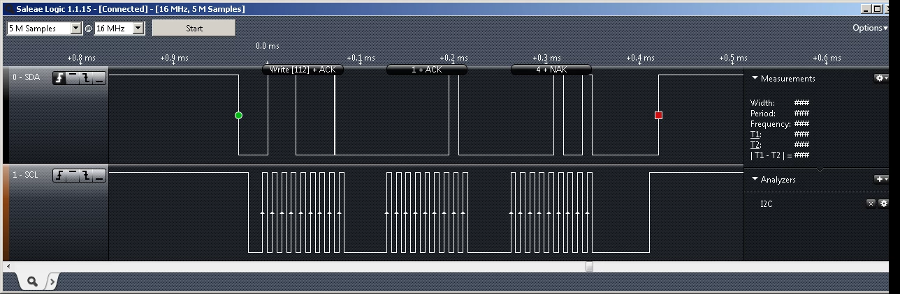

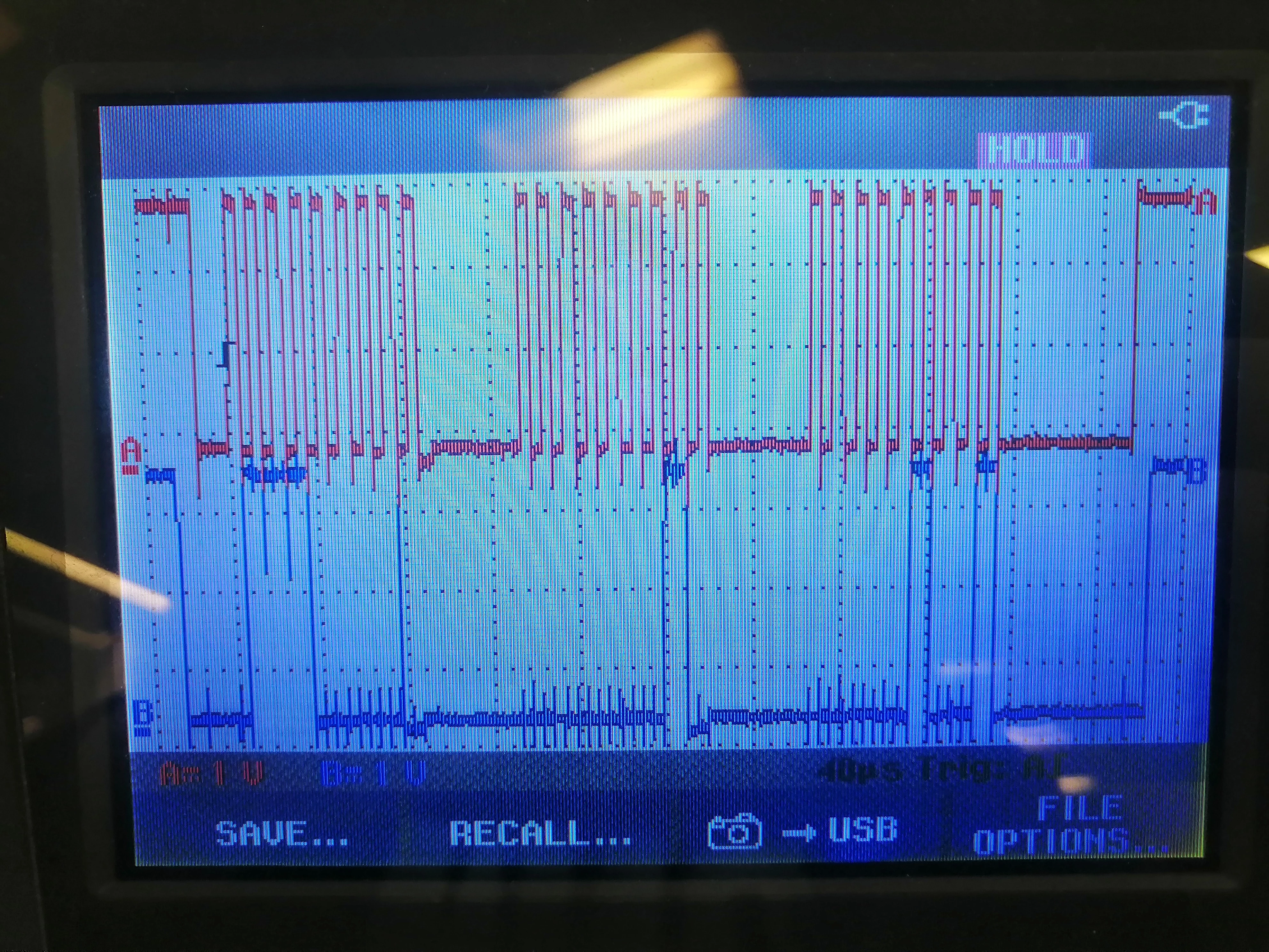

Here are the pictures from osciloscope and logical analyzer (same sequence). Here is the condition but STOPF didn't occured. Last byte in the sequence is not acknowledged for some reasons. Can't see the explanation of getting into BERR.

I can't see anything that would explain BERR in the scope plots. The NACK on the last byte makes sense as you're only receiving 2 bytes. It will NACK the last byte in order to stop the transaction.

That sequence anyway should not lead to BERR in this case. Actualy i found out what is going on. The logic that drives BERR flag in uC is really sensitive to SDA to SCL hold time which can be 0 as per specification. In my case I can't exactly say wether this was violated to negative value (if so, definitely not more than -20 ns) but this was enough to catch wrong START or STOP condition. As soon as my I2C master is FPGA project I increased this hold time to approx less than 50 ns and that was enough to make it work stable. Many thanx for Your help.
September 27, 2021
Thanks for reporting back with the answer.
After looking back at the plots, I can see now that SDA changes state very close to the SCL falling edge. Probably SDA changes state before SCL on one or more of them which is in fact a misplaced start or stop condition. The logic analyzer should catch this, but if the edges are close or overlapping, perhaps the correct logic isn't in the analyzer software.
