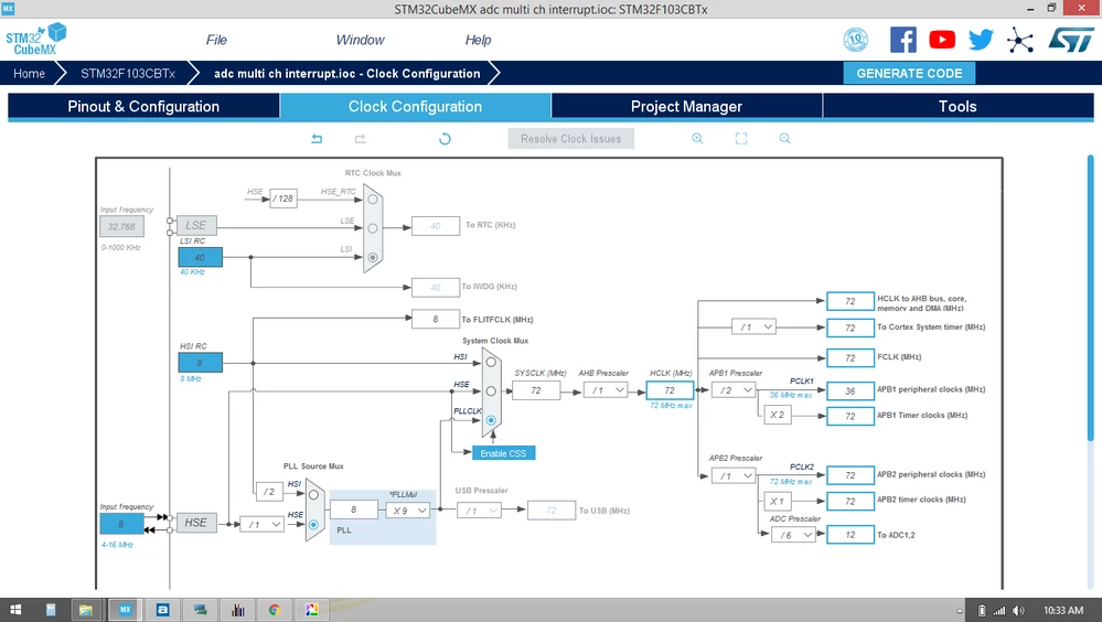

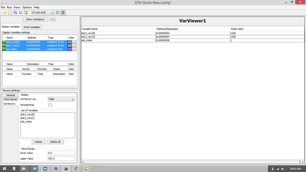

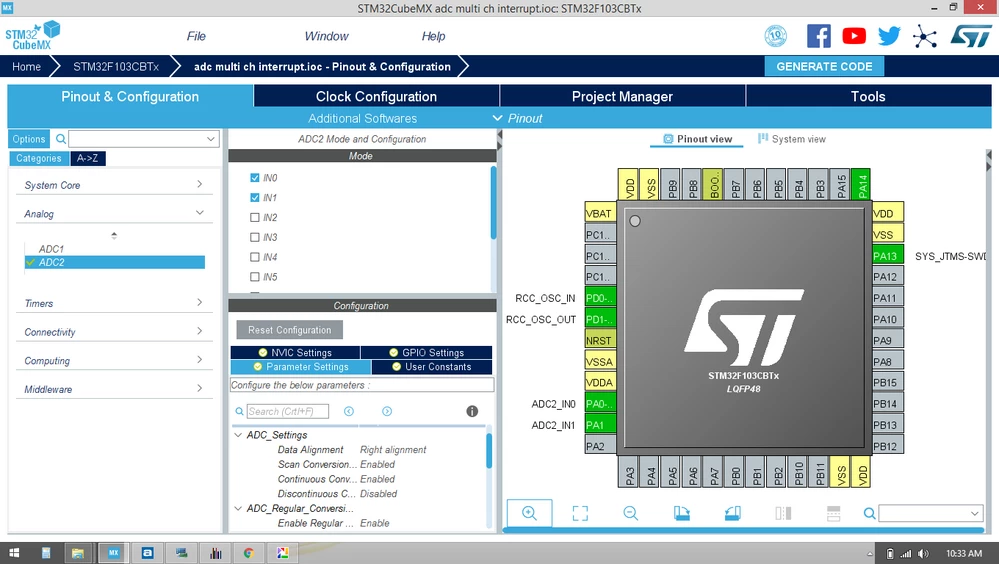

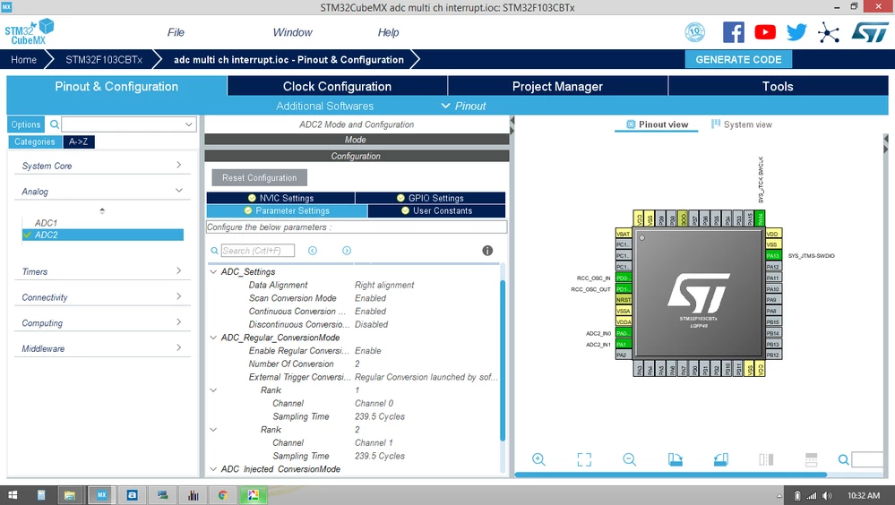

STM32F103CBT6 ADC2 multi channel interrupt mode getting wrong ADC values

  • clock config:
  • ADC2 config:
  • ADC2 multiple channel with interrupt:
  • STM STUDIO getting wrong adc values:
