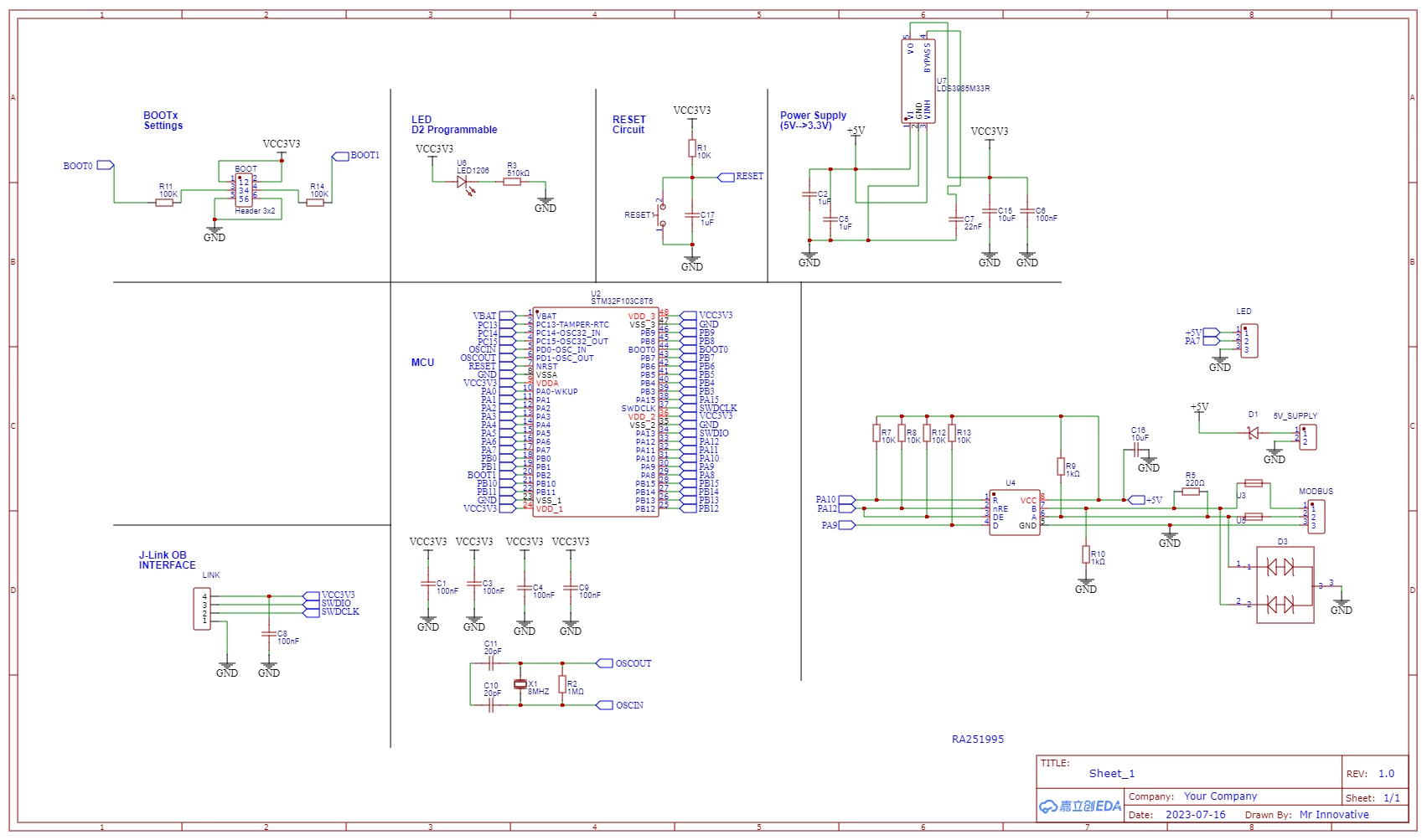

I am attaching the PCB schematic see if I missed any part which effect SPI .

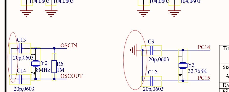

I don't know if this is the case, but I've seen some users mentioning having purchased non-original chips, which can cause adverse functioning than expected.
It seems to me that your schematic has no grounding on the crystal capacitors, I found a Bluepill schematic with the same fault:

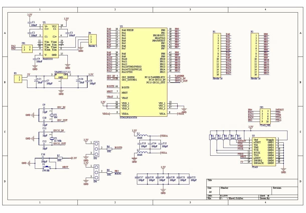

I found a Bluepill schematic without this GND error:
STM32-Schematic
http://land-boards.com/blwiki/index.php?title=STM32_Blue_Pill#Blue_Pill_Card_Schematic

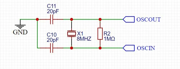

sandeep3AuthorBest answer
July 27, 2023
thanks thanks you solved my big problem its working I applied gnd to the load capacitors and boom its working .
thanks again friend.
now new schematic look like this
RhSilicon
Lead
July 27, 2023
Nice, check in the manuals how to configure the external oscillator, this 1M resistor may not be used.
