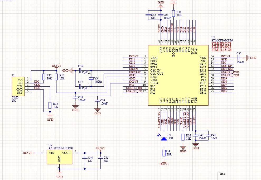

Hi @leo12345678 ,
Try to remove R13, pull-up resistor on reset pin, it is not required. we have one internally.
Hope it helps.
STOne-32.
July 29, 2024
We remove the R13  and it still didn't work, but we blew it with a fan for a while and it came back to normal, so what's going on here? Thank you very much!
Andrew Neil
July 29, 2024
crystal oscillator not starting?
is this board your own design, or purchased from some supplier?
if the latter, is it your own firmware? Do you have any known-good reference firmware?
